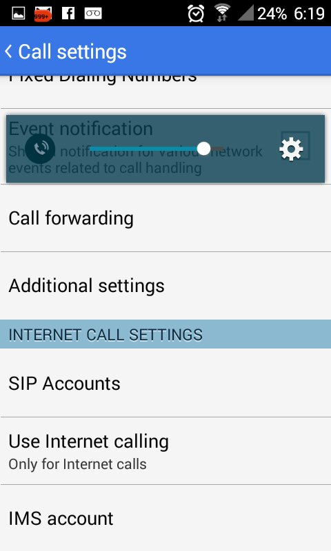

Don't know if this work but you can check if you go in dial and press the three dots in right size a menu will show setting then go in to setting and go in to the bottom of that page and you will find that
