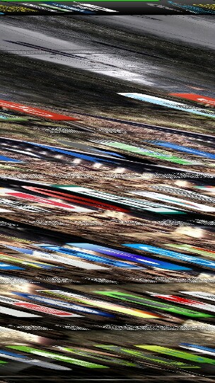

This is what I get using it, and I used all the adjustments in the settings.
I am having absolutely no luck with screenshot apps. I'm not sure exact why it's only happening with my phone, like the update to this rom. I'm beginning to think maybe I should have left well enough alone.

Sorry, using the shutdown menu works and it's not too much of a pain. :rolleyes::eek:
Actually I just checked my settings and am using root 4, try that and see if it works for you.
Is that an application, because I can't find anything named that.
No, it's one of the settings in screen shot ultimate, the other settings come out scrambled like your screen shot but that setting works great on my phone.
