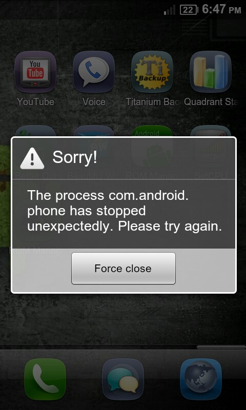

3.When I dial *228 to update my roaming capabilities, I keep getting the following error message and the call gets cancelled:

3. It took 3 calls for me, but it did work the 3rd time using *22899 option (which is the same as doing *228 then option 2)
