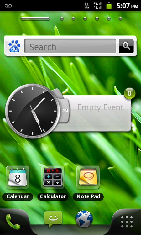

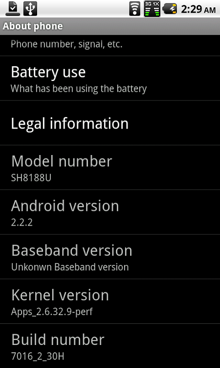

Introducing the Stock Sharp Froyo 2.2.2 ROM for the Triumph!!!
attachment.php
This is a port of the Sharp SH8188U X6 variant Stock 2.2.2 Froyo ROM.
This ROM is fully functional! You will find some nice surprises included in this ROM.
This ROM is deodexed, rooted and includes busybox, so you can easily remove system apps that you don't want. Also, there is a bloat remover in the second post.

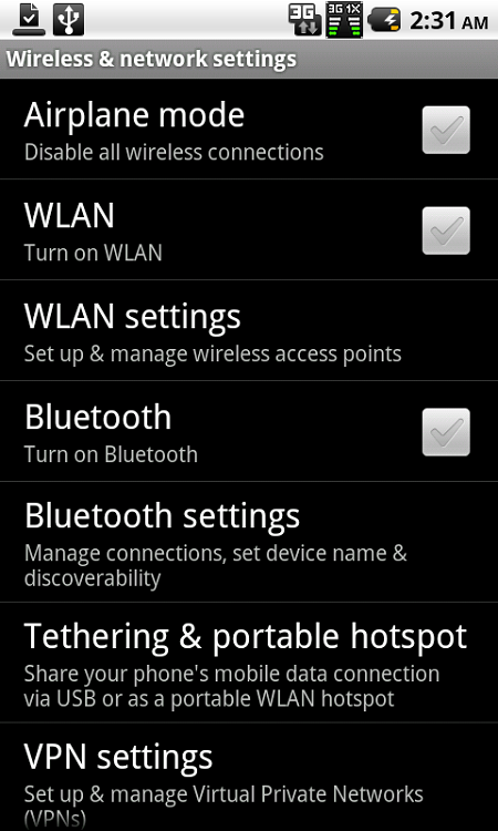

Note: Bluetooth:
Bluetooth does not work in Original, Trim or Deodexed versions. I will be leaving them up for reference, but hiding the discriptions. Bluetooth is working in Deodexed Ver2, Ver3, Ver4 and Deodexed rev 2.1.

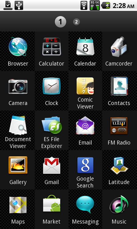

This is the slightly trimmed down version, I removed a few unneeded apps like APR which is a tool to send log files to the manufacturer I think, and a few others. If you have the original version installed, you can just remove/uninstall APR.apk, rthunder2apk.apk and .odex, and SinaSync_Home3_hdpi.apk.
EDIT: You can also remove CXMDFViewer.apk it is the comic viewer app, and is in both Stock and Trim versions.

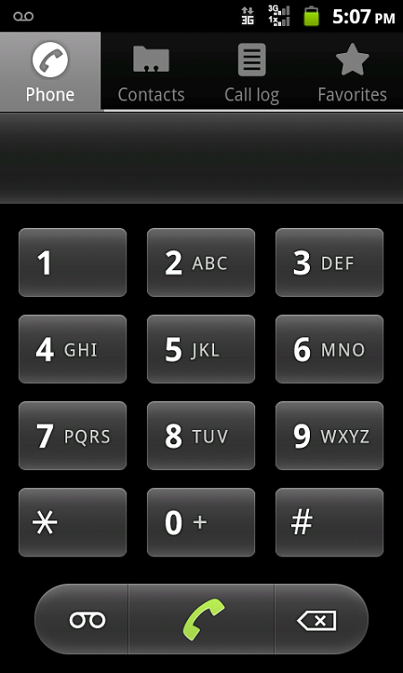

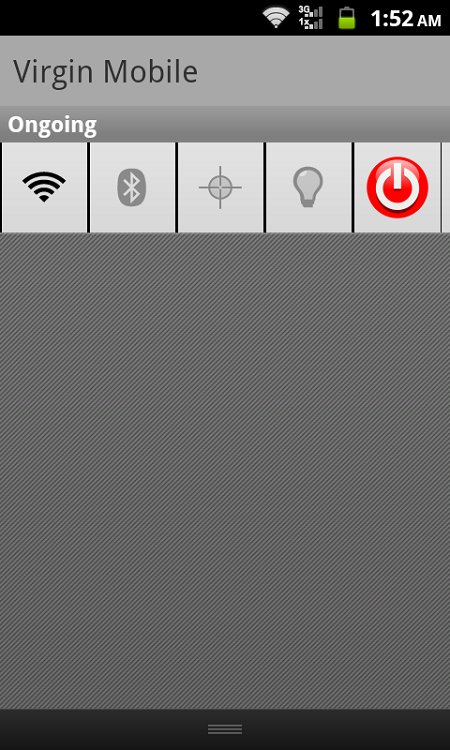

Play Store Link: Status Bar Notification Widgets
attachment.php

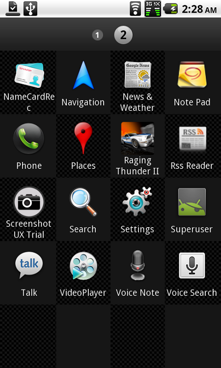

BSydz Stock Sharp 2.2 Triumph Bloat Remover
Installation: Flash in recovery, then reboot.
Removes:
Android_RSS_Home2_FB3_hdpi.apk: RSS Reader
DocViewer.apk: Document Viewer
FileManager_FB3_hdpi.apk: File Manager
FMRadio_Home3_hdpi.apk: FM Radio
NameCardRec.apk: A Business Card Reader/Rolodex
NotePad_FB3_hdpi.apk: Notepad
VoiceNote_FB3_hdpi.apk; Voice Note Taker
GenieWidget.apk: News & Weather app
Note: This is very easy to customize to your liking, just open the zip and edit updater.script in META-INF\com\google\android with notepad++ or your favorite text editor.
