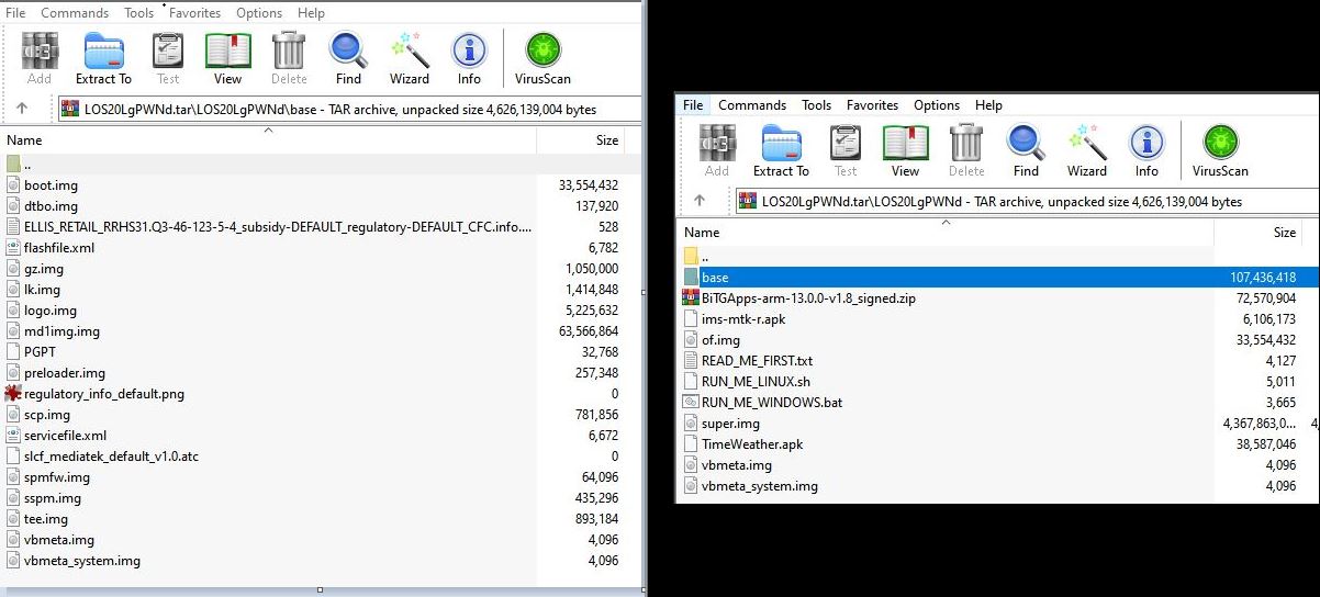

This is my extractor tool for the .tar.lrz format download this zip extract it open that folder and put downloaded rom.tar.lrz into it requires renaming the .tar.lrz file " it's all in the read me " that will leave u with a .tar file that most all unzip utilities can handle. 7z winrar file exploreer what ever.

If you follow the readme and touch don't work in orangefox its because you have a different touch screen than me and we need to load the right firmware for it,If you get with me on telegram we can probably fix it.
here's LOS20
ADDITIONALLY
There is a test build that loads different touch screen in orangefox and you might try it if the one in the LOS20 pak doesn't have touch for you.

So if you have problems with the flasher check that you are using usb 2.0
If you just can't continue instructions in LOS 20 READ_ME_FIRST.txt because of the touchscreen in orangefox then you can use adb and mtp and stuff
to sideload the gapps...
adb shell
twrp sideload
then open other pwrshell or terminal window and do
adb sideload "gapps-package-name.zip"
and score you can still have gapps and magisk and los
DO NOT INSTALL MAGISK.ZIP its already included in orangefox boot.img just install magisk manager apk

Hi Astr4y4L,
I can't connect to Telegram either. I'm trying to extract the Orangefox recovery from the ROM you've uploaded to Mega, which file is it?
I've got the second Orangefox recovery (the one for different touch screens) but I'm trying to extract the Orangefox recovery file from the ROM you've uploaded to Mega, which file is it? I've attached a screenshot of the archive's content.
Thanks!
