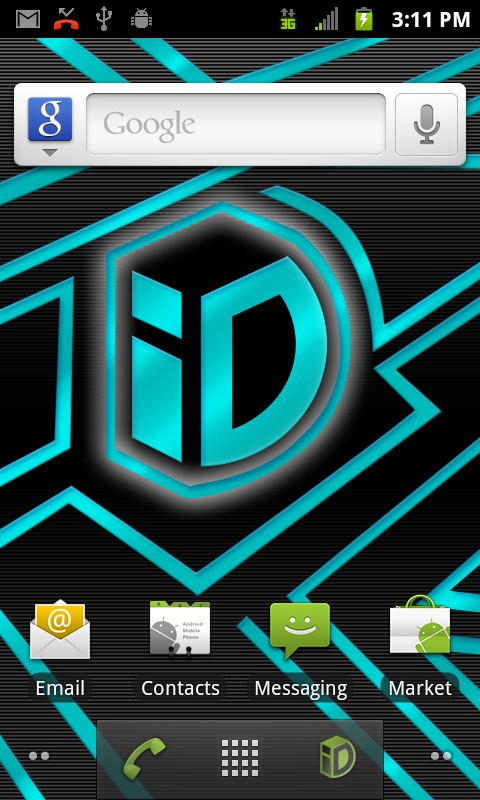

Edit: Mine works...it seems so far, anyways. Just did a test call from my other cell phone and this ROM received the call. My Menu key works as it should, as does my Home key. Will continue to run this tonight and test it some more.
Edit 2: Superuser appears to not be working correctly. Rom Toolbox is denying me access, and Root Explorer is, as well. I re-rooted using my original LG Esteem One-click root and it works great.
