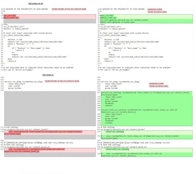

got me thinking, and i popped open the ramdisk of what was on my phone after the zv4 flash, and the boot.img in the zv4 zip and found a few differences, which leads me to believe that the boot.img didnt flash. (at least mine didnt) would we be cool just making an update zip to flash boot, or would aboot stop us from doing that?
attached is a image with 2 sections of diffs from 2 different files, init.zetaw.rc, and init.zetaw.ssr.sh. on the left is what was on the ramdisk of the phone after flashing zv4, and on the right is the ramdisk of zv4 zip.
I didnt really dig too deep other than just checking file sizes for changes and noting the changes when something was different, and i'm not really sure if the changes I found even really help us at all, they seem really insignificant. It looks like it deals with wifi in some way. There could have been more changes in the zimage, but someone who is better with kernel stuff could check that from the sources lg posts on their opensource website.
