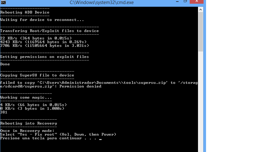

hello, Help, I get the following error::
Copying SuperSU file to device
failed to copy C:\Users\Administrator\documents\\tools\supersu.zip to \storage\sdcard0\supersu.zip : Permission denied
I've tried several sd
HELP!!!!
hello, Help, I get the following error, please help me.
Hi, I tried the version 3 root method and during the installation of the superSU zip, I keep seeing the error message: permission denied. What do I do now?
