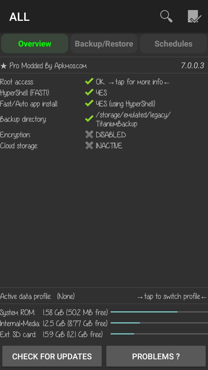

I tried the immersive me module and I remove the navigation bar modified the build.prop with qemu.hw.mainkeys=1 to remove navigation bar but it seems that the navigation bar wants to come back even the status bar keeps coming back it doesn't stay hiding like in my nexus this is how it looks when it works.
