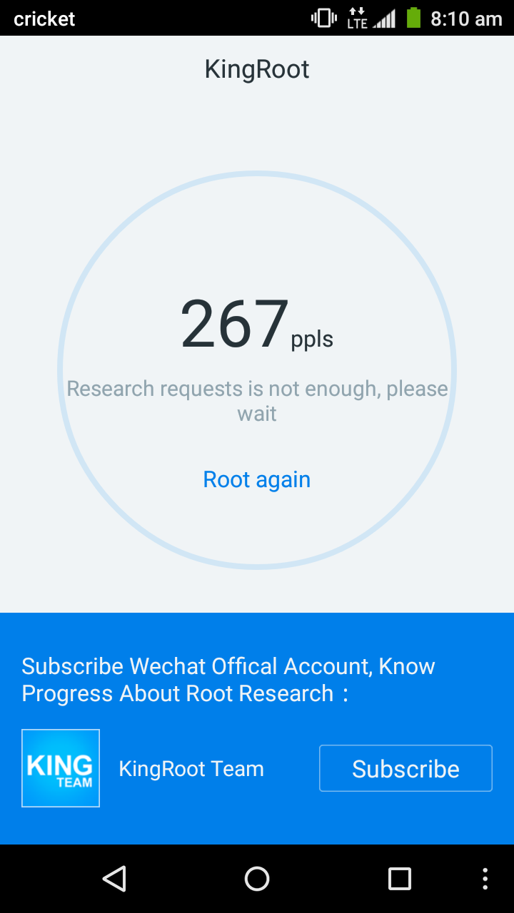

New and updated V 4.6.0 beta1 of KingRoot on Z987 5.1 OTA strategy available but not successful still waiting on root methods..
