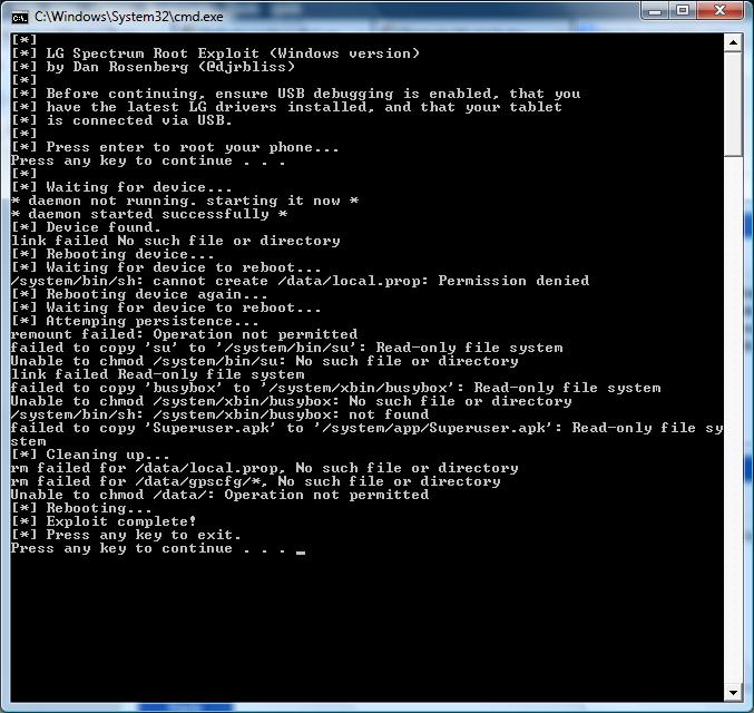

I can't get this to work either. Maybe I'm tarded. Attached is the screenshot of the run.bat
Any help for us noobs?

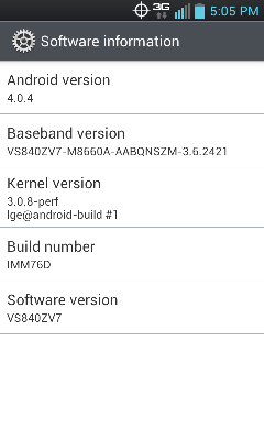

LG Lucid running
Android version 4.0.4
Baseband version VS840ZV7-M8660A-AABQNSZM-3.6.2421
kernel version 3.0.8-perf
lge@android-build #1
build # IMM76D
software version VS840ZV7

Its my work phone (I work for a wireless carrier)
Nope we are still at:
android version 2.3.6
baseband version vs840zv6-m8660a-aabqnszm-3.1.61035ft
kernel version 2.6.35.11-perf lge@android-build #1
build number grk39f
sw version vs840zv6

I did post a screenshot from my phone look again. I think the "missing link" comment was about your post where you posted the link to the Nexus stuff.
Its definitely a LG Lucid and it definitely is running ICS. I asked around at work and it is part of a preproduction test where we get the software pushed to us and test it out a provide feedback to the manufacturer.
What other screenshots would you like to see? Or by "image" do you mean copying the software? Don't know how to do that.

Well you could pull up the software info screen again showing the build,,, etc and take a photo with a camera and post it, that way you show it really is a Lucid and with the software screen up it shows what you're running so that way there won't be no way to say it's fake, unless of course you've played with the build prop.... LOL
