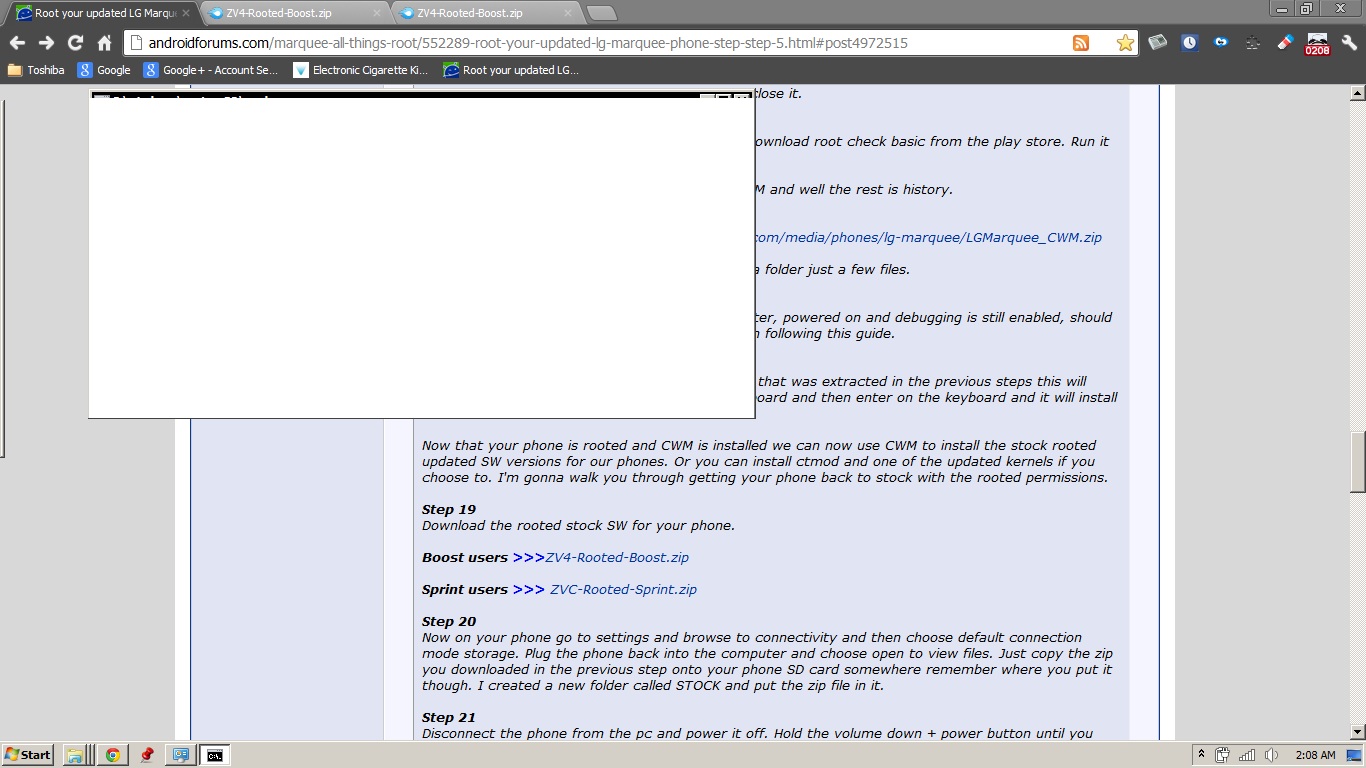

I Have tried rooted my Boost Mobile LG MARQUEE multiple times with no success I am getting really frustrated and every time i post for help i can never find it ir nobody is reading it but i tried THIS ONE and its not working and i have windows 7 i did all the updates on the phone didnt work, did a factory reset didnt do any updates didnt work so i did all the updates again i dont know what i am doing wrong!!!
I have USB DEBUGGING on and i selected MASS STORAGE and it still does nothing

Ok, let me describe in more detail.
It's not working, and here is what I am seeing:
I wait 12 seconds, turn on phone... immediately these two line items pop up:
I never get more than those two line items above, no matter if I wait 5,10,12,14 seconds. Is this normal?
Recently after I press the software update button in the LG updater, the program says "Not Responding" (in the title bar) for 5 seconds or so. This is the standard "Not Responding" behavior in Windows 7.
Any ideas? I updated to latest drivers, and all. Thanks!
