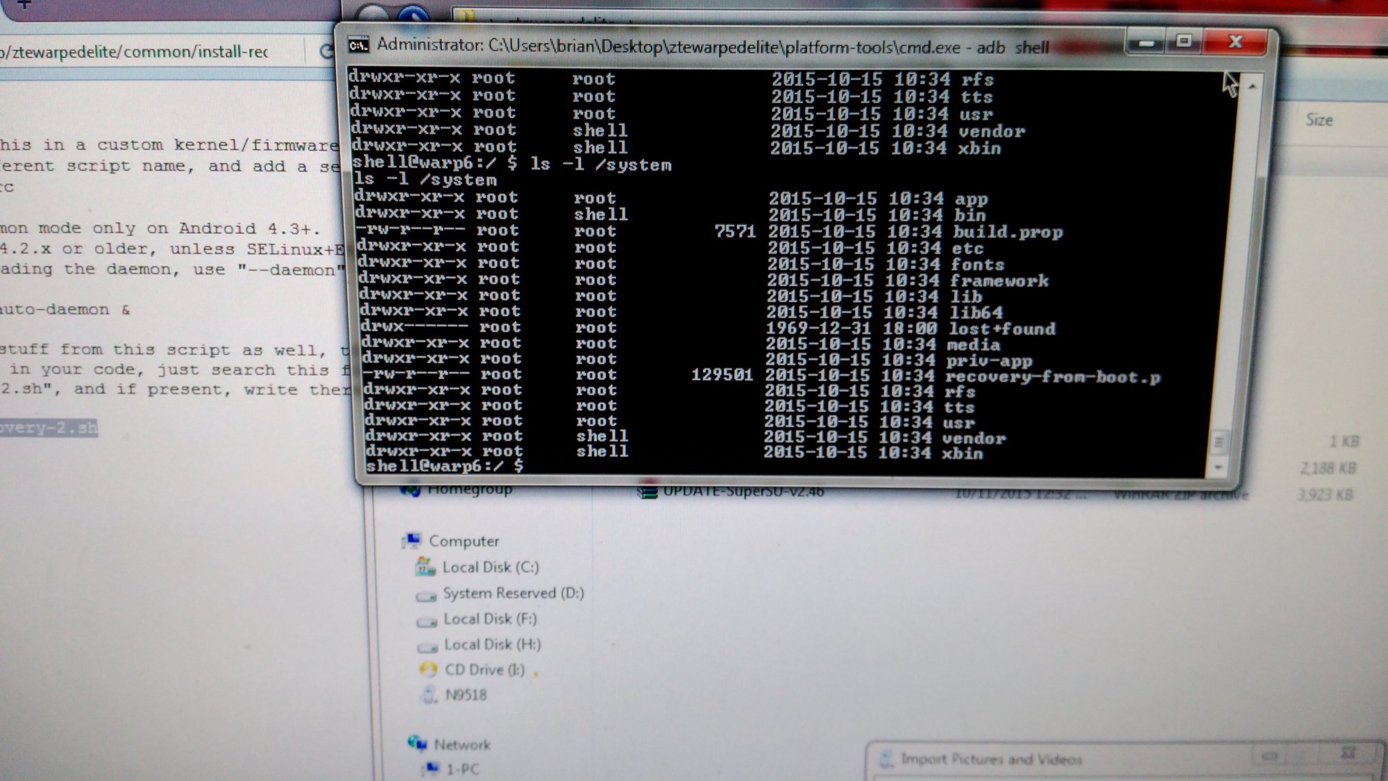

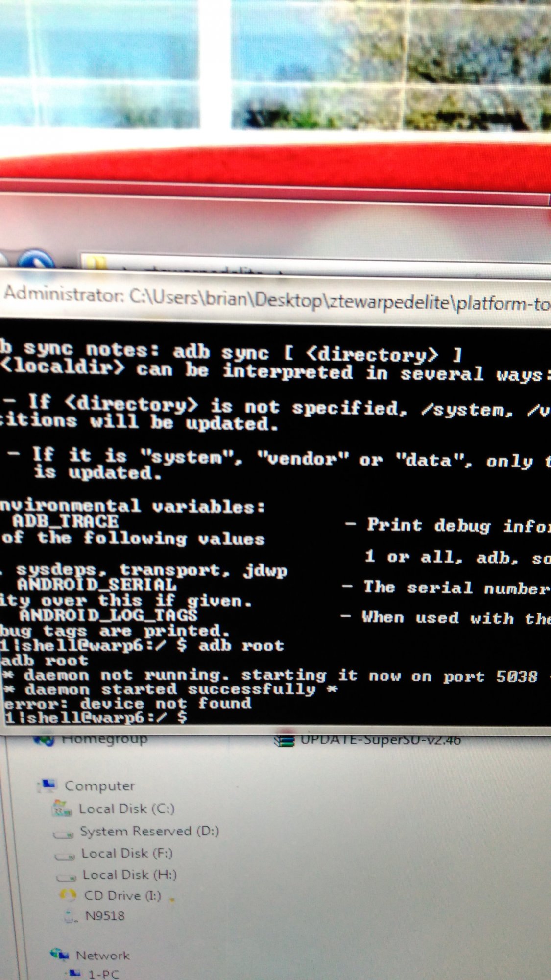

Well I think I might have gotten a root shell.
Idk though.

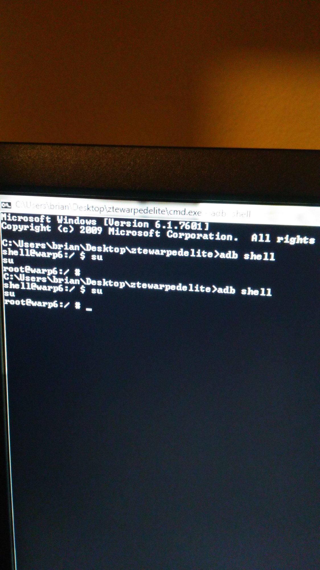

I got temp root and managed to get busy box installed in /system/xbin, but my phone got rebooted by accident in rom toolbox, oops. Trying to get temp root again.
Good job! 2 of 3 down, are you able to also upload a stock Nandroid (TWRP version)? Use Online Nandroid.apk while in temp Root. That'll make all 3 files needed to help a Dev achieve making a TWRP recovery for ya.. Plus if the recovery is successful, I can make stock unmodified &/or Deodexed ROMs

No.. Root would be a "#" symbol instead of "$"
