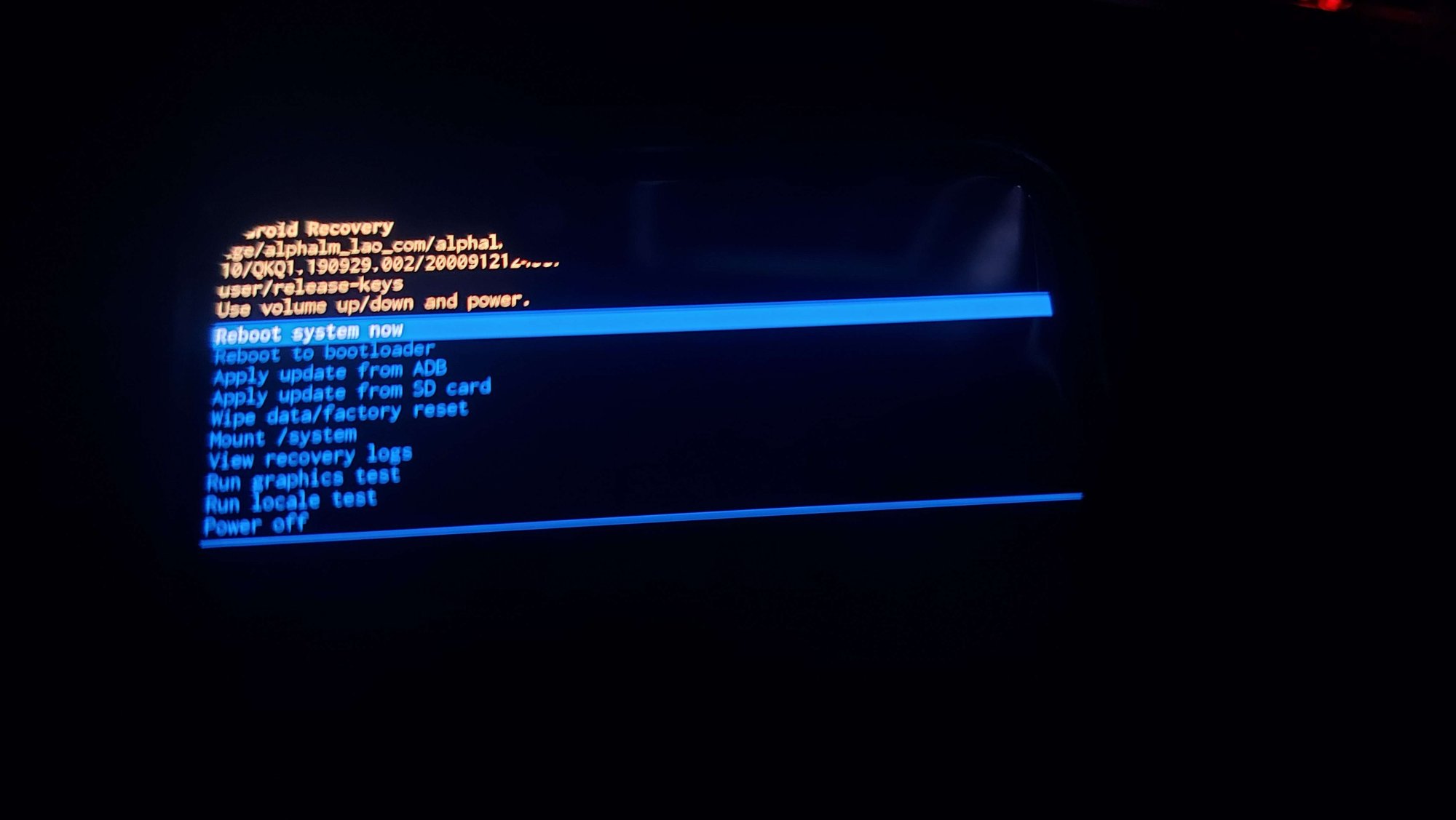

OK so this app called magisk manager wanted to update and I decided to download and install the update, it then wanted to restart but before the restart it said something about how it shouldn't be running as an app, that its not supported and should be running as a user app, the phone restarted and proceeded to bootloop. I was able to factory reset the phone in the recovery. I don't think this phone should have such recovery menu but it does. After that I tried to remove the magisk manager and it gives me two options: restore images and complete uninstall. Pressing on "restore images" gives a message "stock backup does not exist!" and pressing "complete uninstall" doesn't do anything. Also the battery went from 39 or so percent to 13 after one of the reboots I did. Something is wrong here. Maybe this firmware is not worth backing up.
ok so what is odd is that the previous owner rooted the phone but never installed a custom recovery. that image is of the stock recovery, what you did is called a hard reset vs a factory reset. you should just uninstall magisk app from the phone. were you able to find a stock rom for your phone?
