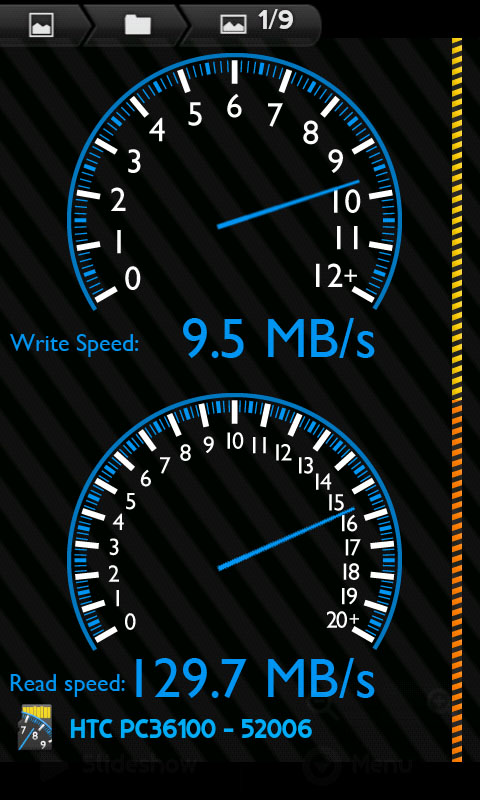

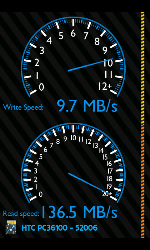

Well, I still haven't gotten the hang of posting screen shots so I attached the 2 I had of the high end read numbers for my Class 10 card.

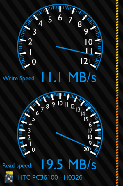

first, how does everyone get their pics so big? second, here are my results with stock sd card...
EDIT - also, how do you know what class your card is? any way of checking it thru the phone? is it written on the card? just wonderin...
