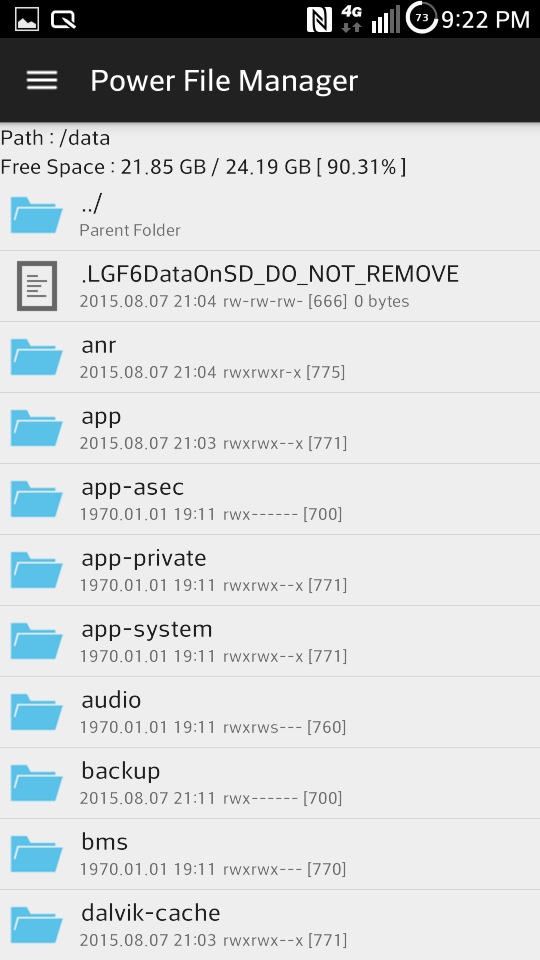

Thank you all for the hard work! I was able to follow the instructions and get the phone boot up with more than 20G free space in /data shown in the Power File Manager. However, it still fail to install apps due to insufficient storage. Here are some screenshots I took:
Well, I think you're the first person to report the infamous insufficient storage error with this hack. With enough space, this error should not occur with this hack in theory. The hack mounts the external partition before the core of Android is loaded. So the only space for /data as far as Android knows is the external ext4 volume. Maybe you've used other Android-based SD hacks before and there's a conflict? If you have and you choose to continue to use this hack instead, it's best to revert changes made by those hacks so that nothing interferes with Android itself.
In your case, I see you're trying to install HERE Maps. I've done that. When I did it, my external volume was only 4GB at the time and it installed without any problem. Have you previously tried to install it before using this hack? Maybe some files were left behind? If you've tried before, check the folder /data/app for "com.here.app.maps-*.*". And if the app is not currently installed, delete any "com.here.app.maps-*.*" file (-1.* or -2.* or both). If the app is already installed but it won't update, uninstall it, delete any "/data/app/com.here.app.maps-*.*", and reinstall. I hope that makes sense.
You are right, WarrantyVoider. This is exactly the issue. I recalled today that I did "pm set-install-location 2" to set the default installation location to be external. This might have caused confusion to the SD hacked system when it tried to install apps. Once I change the install location back to internal, everything works fine.
Thanks a lot for the help!
