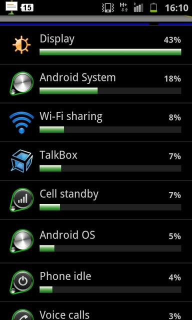

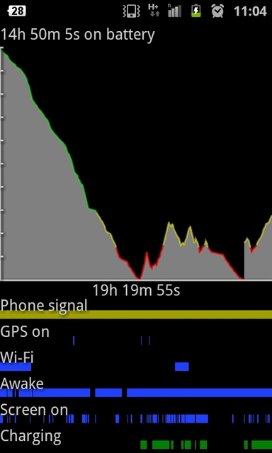

Hi. I just bought my Galaxy S2. On my first day of using it, the battery dies in 10 hours..
I unplug it in 8am, and it dies on 6pm..
And I didn't use much on it.. but I noticed the phone gets hot while it's lock and idle.. I tried to close all the background running apps with the stock task manager..
Is the Android OS 18% usage normal?
Why does the phone still awake even when the screen is locked?
I have attached the battery usage picture. Please help me :(

However, why will it get hot while it's idle? The iPhone4 I had before does not get hot in the same location with the same carrier.. does it shouldn't be the weak signal causes the battery drain.. On the other hand, is that normal that the phone is awake all the time even the phone is locked? Does your phone still awake all time as well?

Sounds like an app background process is hung or running in the background.. Download watchdog and take a look at some of the processes running
I'm new to android after using iOS since 1.1.1..
I don't even know which is normal processes, while which isn't..
Does watchdog states how much battery or % each processes use? Or which will keep the phone awake?
In the end, is the long awake bar normal or abnormal for android?

Could you check the graph on the battery usage and let me know whether the awake time on yours is non stop or it just mine that does that?

I think I found out which app caused the battery drain..
After I reset my phone back to factory settings, I installed one app by one app and also reading the comments on each app..
I found out Talkbox, the 2nd app that I download once I use the phone, is a battery drainer..
I have installed 80% of my apps back.. and everything is working fine.. The awake bar stops when my led monitor is off...
Thanks everyone's help on this post!
