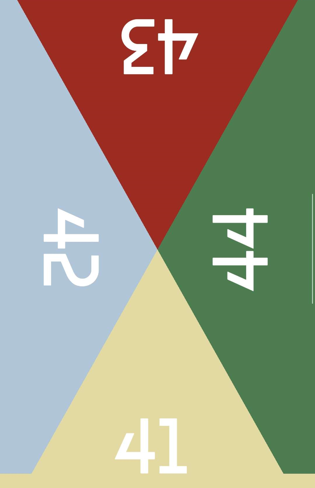

Hi there, some questions about preventing a component from detecting touch from users (like the title). I'm developing an app that has a background rendered with OpenGL that also has a few TextView components layered on top of them:
The desired functionality is so that each horizontal half of the "triangles" can be pressed, with the left side (if oriented towards oneself) decreasing the number and the right incrementing it.
My current struggle is removing the ability for the TextView components to be interacted with, as they greatly reduce the "clickable" areas within the triangles:
As you can see, when you press directly on the TextView the component highlights itself and prevents the touch from being detected by the OpenGL layer.
