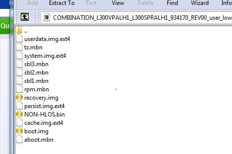

i don't know - adb won't connect via usb, i got this file today, is it anything that might help?
COMBINATION_L300VPALH1_L300SPRALH1_934170_REV00_user_low_ship.tar
I attached a screen capture of the files.
kim

im having a bit of a processing error in my brain, so what is s&g?
edit: I figured it out, but a very childish phrase smh
that leak is dated five days in the future. What that means is that your device must ride with the files until the posted date and THEN it will begin working. Like a time release safe. Thanks for the leak info though. I'm gonna add them props to my junk.
