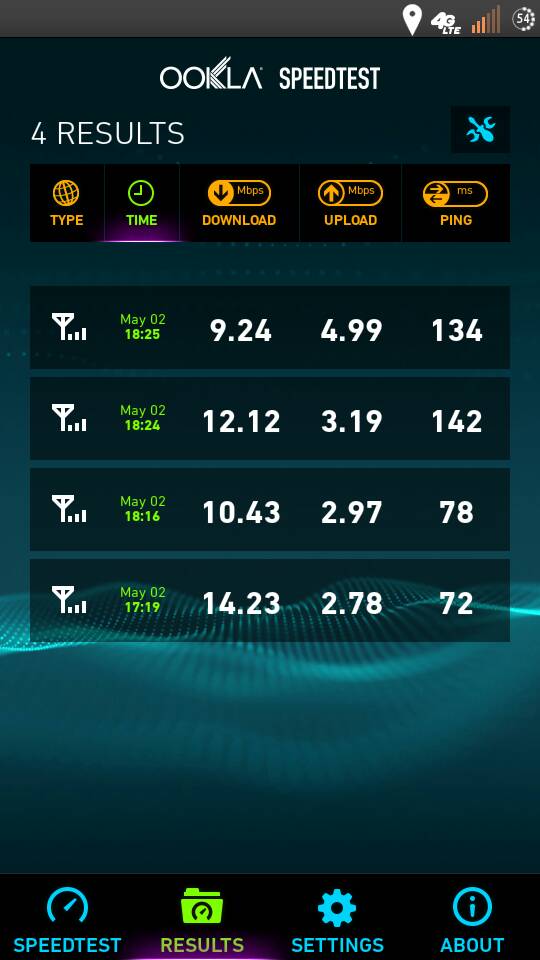

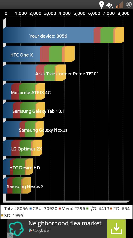

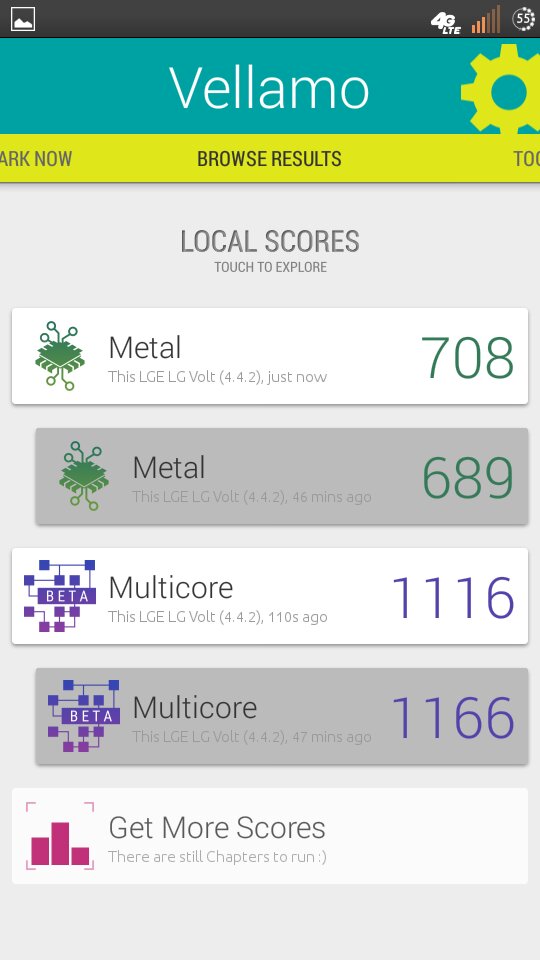

Flashed it and ran some benchmarks, here's some screenshots. On the Vellamo screenshot, the gray scores are with the stock kernel. On the Speed test, the bottom score is stock. The Quadrant are listed stock first.
Not sure if these are anomalous or indicative of possible issues with the kernel.
Oops... Hit the wrong button. As you can see, in Quadrant, the score dropped about 200 points. In speed test, the stock test was solid speed for the whole test, after flashing, it would slowly degrade as the rest proceeded. Vellamo kind of traded off on the 2 tests... One got better, the other got worse.

You'll have to check which governor and io scheduler your running. I set them differently from stock kernel. I know governor is interactive default in volt uno, I don't remember which io scheduler I set default though. That can make the difference in benchmarks. I'll set them to reflect the stock kernel default and re release.
Edit: i guess row was default io sched and interactive was default governor, where row and on demand were default in stock. I changed it to reflect stock and am rebuilding.
This means you guys will have to change gov and io sched to what you want, I won't deviate from stock defaults.

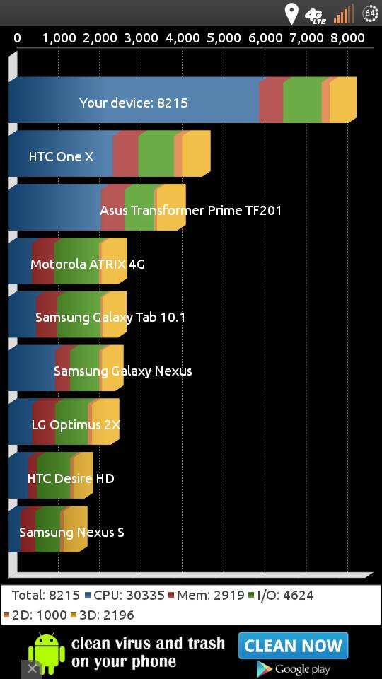

I do see all the governors listed when using the CPU tools in RomTool box. I also used it to run a benchmark then reverted to stock and ran another for comparison. In the picture. Uno is the top one and stock is below it.

Yup, it's installed. I set it to interactive and row with no frills.

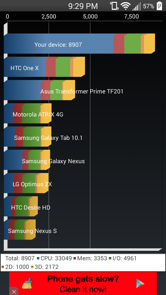

heres a screenshot of quadrant using this kernel. its about 700higher than the other one posted earlier in this thread.
