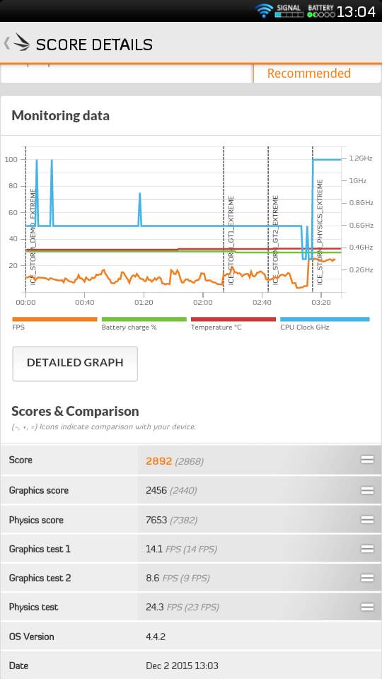

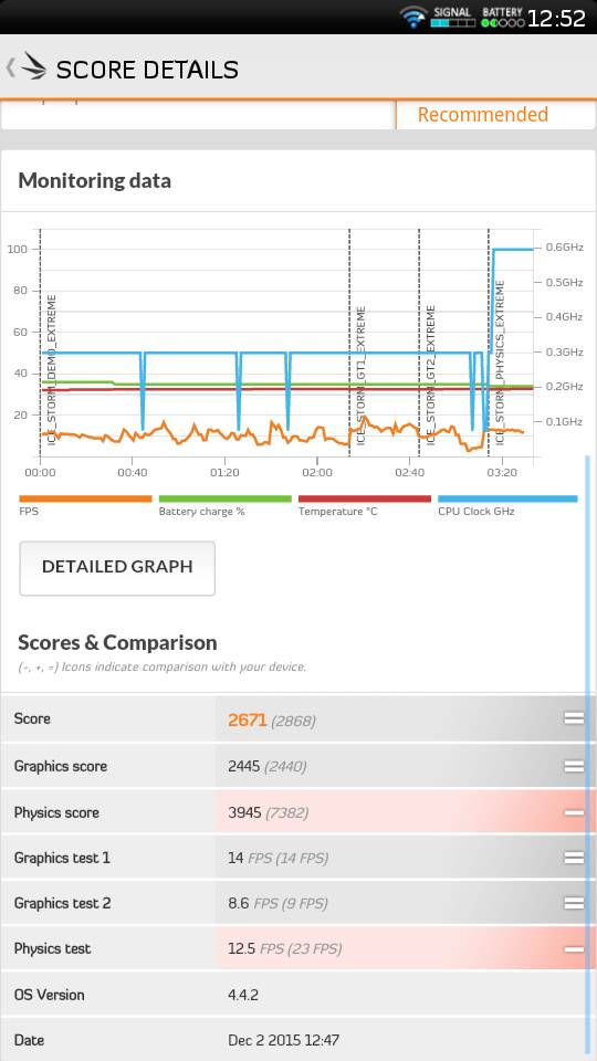

Just gave the new beta a test. Installed the new version of Curtis's stock ROM along with the kernel. Ran a benchmark with 3Dmark and the physics test tanked, with nothing else showing significant improvement over stock. For control purposes, I installed the stock kernel and ran another test, getting expected results. It looks like, according to the graph, the CPU bottomed out several times during the test, while it spiked on stock. There's interesting differences in the battery and temp lines too. Here's screenshots, beta first, then stock.
(The scores in parenthesis are stock baseline scores provided by the app)
Make sure you disable mpdecision and intelliplug, enable all cores (intelliplug won't turn them on once it's disabled) and switch to the performance governor, before you bench.
