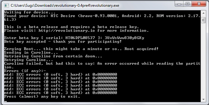

Tried to Root phone a few months back with Unrevoked and messed it right up (until android forums saved me) as my contract is ending i decided to take plunge again and try with revolutionary
I have Orange UK HTC Desire on 2.2 revolutionary worked ok but then have the errors message and I have no idea what to try next :)

took out the sim card as well but using either program i get some type of error. I added the screen shot from revolutionary in my first post that is my error message.

hmmm you say revolutionary worked but by that screenshot it tells me it didnt.
if you boot to hboot (voldown + power) does it say revolutionary at the top?
if not then it failed fully.

Revolutionary didn't work they both seem as though they work then I get the error message either the error as in the image with Revolutionary or the CID error with Unrevoked.
Just can't seem to get past a certain point with either tool, the phone works fine just I cant seem to root it anyway.

its a misc error
you have two options. temp root and go through the usb brick fix guide in the tips and tricks section
downgrade using teppics downgrader to a 2.1 rom and root via unrevoked 3.21 then flash a custom up-to-date-rom

there seems to be some problem writing to the misc partion Why & how i do not know. A few times it failed to load and went to screen with red triangle and whatever i tried to do i had same message

the usb brick fix restores the misc partition which gets corrupted. in most cases this causes usb bricks but in some its just corrupted. doing the usb brick fix repairs this.
if you want to get off 2.1 you have a gold card (from doing teppics downgrader) so try running the stock 2.2 WWE RUU to bring it back to froyo and then do the usb brick fix
if you still have no signal on the phone then you should probably run the unlock utility from xda to unlock the sim
