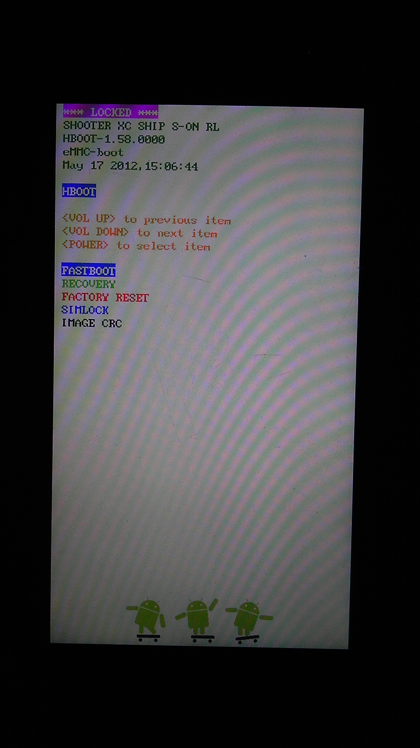

Can you tell me the information from the bootloader screen? Up at the top where it said LOCKED there should be some other numbers and stuff. Not in the fastboot menu but the first bootloader screen.

Here is a screenshot of my phone. I am pretty sure I have run all of the phone system and software updates.
I figured it was a long shot that you hadn't taken the OTAs but just had to make sure just in case we had the ruu as an option.
