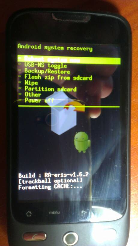

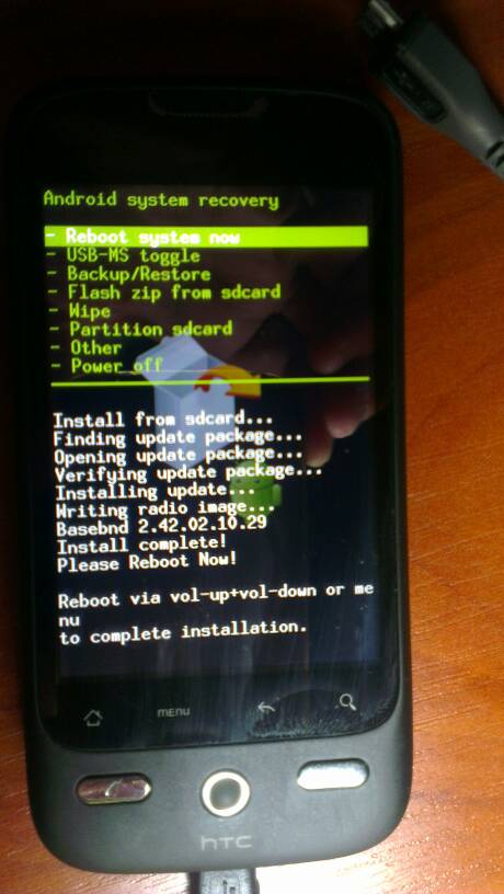

I tried to flash radio twice, but there were no result - it's a bad news .
And the good news are that I'm ruining new recovery :thumbup::thumbup:
It flashed thru recovery preetty nice
C:\Users\Влад\Desktop\mini>fastboot flash recovery recovery-RA-eris-v1.6.2-track
ball-optional.img
sending 'recovery' (3834 KB)... OKAY [ 0.835s]
writing 'recovery'... OKAY [ 1.391s]
finished. total time: 2.227s

Try the one attached. I think that I attached a Sprint HTC Hero radio the last time anyway. It should have worked, but this one was the official Eris July 2010 OTA radio.
MD5 is c96ad832cfa22f1f1cf56f1a45b8a5ef
It's possible that there is an error where the radio is flashed. I don't think so, though; there was no error in the flash in the photo you showed in your last post.
vladrytskiy,
Your first image looks like the radio did flash successfully...did you check the current baseband version in the Settings -> About phone to verify?
Congrats on the S-OFF HBOOT and the new recovery ;) :).
yes it looked like twice to be ok i made 2 attempts to flash it, but in hboot as you see there is the old one version.
