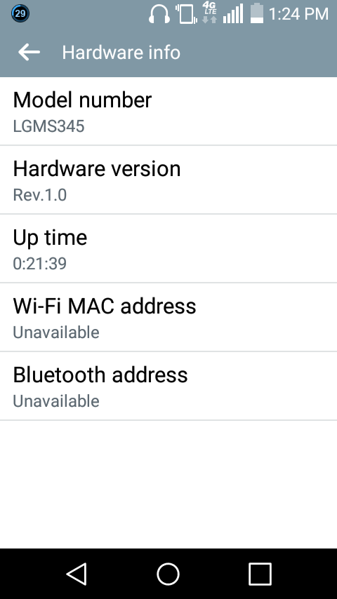

I'm having this same issue. Any help would be awesomeI flash the twrp with flashify but the issue im having is booting into recovery so i can do a back upView attachment 90131
Download twrp manager check to see you have the recovery installed first ..than in twrp manager just boot to recovery it works every time.I flash the twrp with flashify but the issue im having is booting into recovery so i can do a back upView attachment 90131
Still didn't work with twrpDownload twrp manager check to see you have the recovery installed first ..than in twrp manager just boot to recovery it works every time.
Can you screenshot install twrp screen? Does it show you have twrp installed?Still didn't work with twrp
Yes it tells me it got TWRP but it won't go into recoveryCan you screenshot install twrp screen? Does it show you have twrp installed?
Try powering down,then holding vol down & power until you see the lg logo then release power and continue holding vol down then hold power again until you get to the factory reset screen.select yes then again to confirm,it should boot twrp.i have the same issue,on the tmobile variant i cannot automatically boot into twrp i have to use the buttons to do it manually.Yes it tells me it got TWRP but it won't go into recovery
