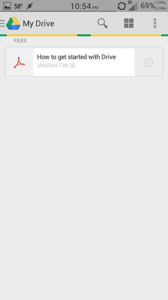

I've already uploaded the file.

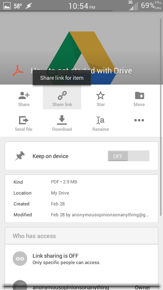

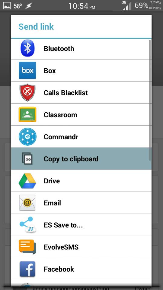

Alright, now in google drive, click the "i" inside a circle and then click share link, then click copy to clipboard, then paste it in a reply

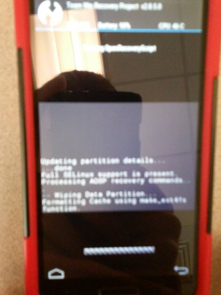

Screenshots show darkened area to touch

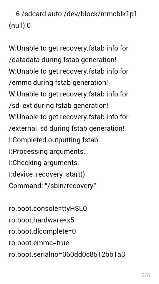

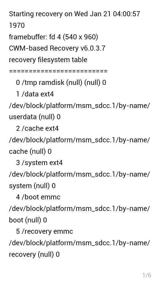

Now I am confused. This log is fubar. The date is WAY off. The recovery type is wrong. The contents don't tell me what I was looking for. There are errors, but I am unsure if they are related. One question, was the last thing you did with the recovery a factory reset or a flash via flashify?
Video of the entire thing, from the phone being off to the end of the wipes, will help me understand EXACTLY what is going on.
The log is not telling me that it is wiping anything, let alone loading a script to do so, at least as far as I can tell.
