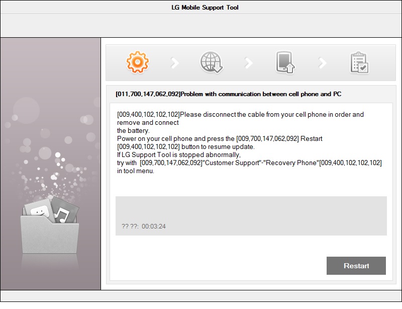

I plugged it in and lg mobile support tool says v10b. If I go into download mode and load the support tool it says 10B with an upgrade to 10E available so should I
  1. Try and upgrade to 10E via the support too?
  2. Use the OP method to flash 10D?
  3. Use the OP method to flash 10E?
It's a soft bricked phone for a month now so I'm not too concerned with what happens to it.
I suggest using o.o instructions to either go to 10b or 10e. Not much of a matter right now, as I am sure bootloader is locked inboth releases.

Well I got to the last step but the LG tool keeps capping out on me:
My phone has the "Firmware Update" screen just fine and I can see the LGE Mobile USB as COM20 just fine so not sure where its breaking down.
It seems you have three choices =)
If it's fully charged and the other methods were unsuccessful, maybe using the tool to upgrade to 10E will be worth a try.
