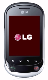

Hello I wonder if you can help me I seem to have bricked my LG Optimus Chat C550 Android phone by using a rom manager and it didnt like it. Now all I get when I turn on my phone is an LG boot screen and its stuck and the lights on the qwerty pull out keyboard flash on and off, the computer dont recognise the phone when plugged in by USB cable. Have tried your suggestion but my C550 has no camera button and the back key is not a key as such its a 'touch' sensitive key - the only proper button keys are the send and end buttons and the volume up and down button and the pull out qwerty keyboard - am I stuffed do you reckon? please help if you can I really liked this phone before I bricked it :(. Thanks in advance for any help/advice. Andy from Ireland.
