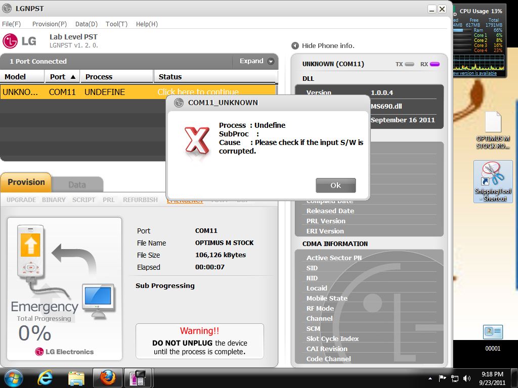

Can some1 please tell me what i can do about this.... when i try to unbrick my phone this shows up....

This method will fix any phone that will light up.
Don't wait for the battery to drain, unplug power, pull battery, then hold down all the buttons and pop the batt back in or plug power in.
