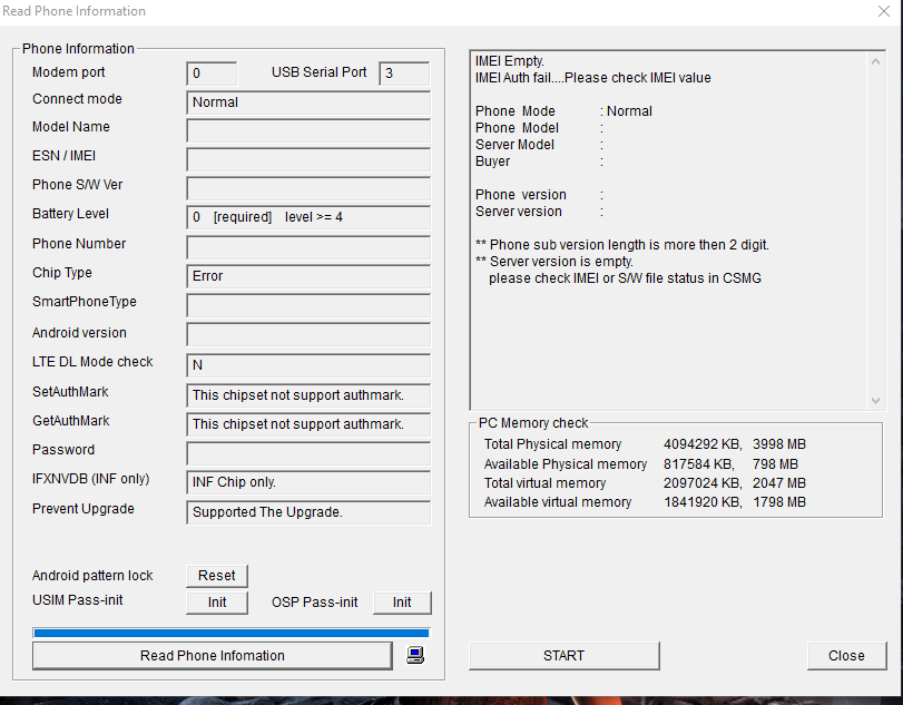

I also can read some information about the phone in the flash tool app

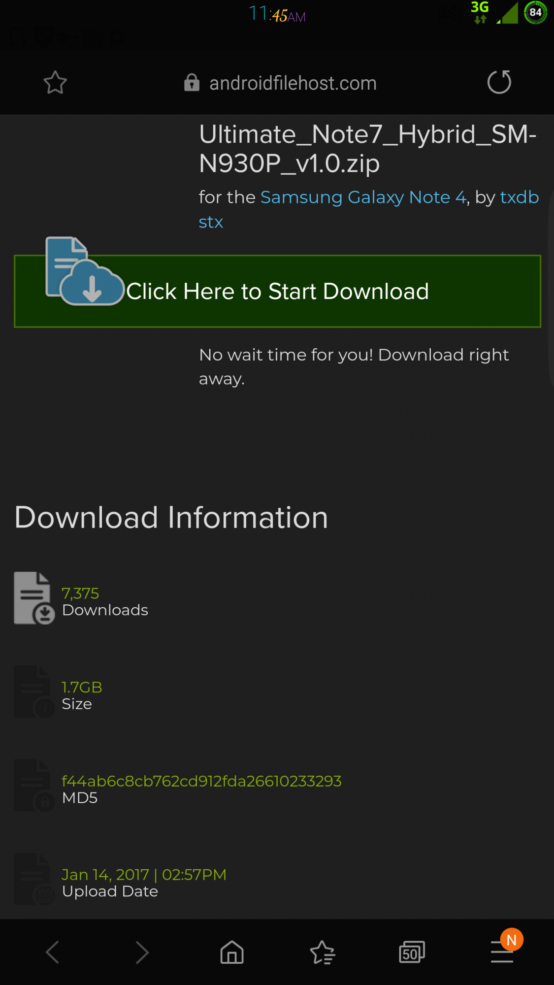

Look for something like Md5 or hash tag where you download the firmware. This is an example of a rom that is available for my device. See the md5 ? I copy and past that to my Md5 (hash tag) checker and confirm the the validity of my download. If they dont match, I know my download is corrupted.

I use a different Md5 checker that is no longer available on Google PS. I just place my download in the provided slot (parh), then I press calculate and the results appear (2nd image), next copy past the Md5 from the site to the slot maked compare and press the compare function (3rd image). Its a match then the download is valid.
If they indeed match at least you can rule out that as a possibility cause. If they don't then you know why your are experiencing an error.
