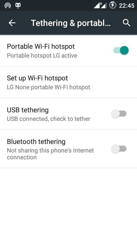

I reverted back to 12.0 to see if hotspot works even with password and it did. So I clean-installed 12.1 again but still my laptop can't connect if the hotspot have a password... It just says "Cant connect to this network".
By the way here is a screenshot. It says hotspot is active but there's not a hotspot icon on the status bar. Any suggestions please? :( Screenshot_2015-04-08-22-17-20.png
By the way here is a screenshot. It says hotspot is active but there's not a hotspot icon on the status bar. Any suggestions please? :(View attachment 85388
I try connect from another android phone and all works. Also no icon, but all work.
Does it have a password? Cause my laptop can connect to the hotspot if it doesn't have password. And when it's connected the icon will show on the status bar.
