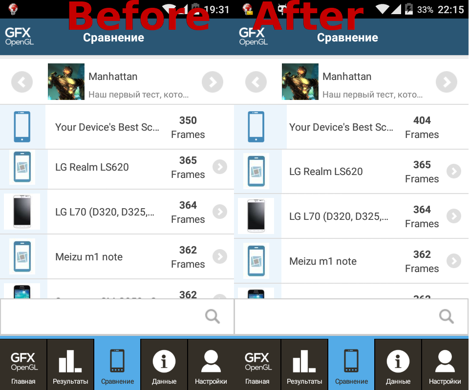

Please help me to install/update the framework.. I have download, install and check the modules box and then I can't tap install/update framework.. If I just reboot, there will be no impact on the modules.
