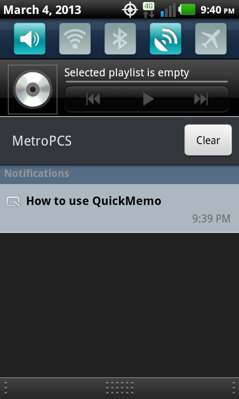

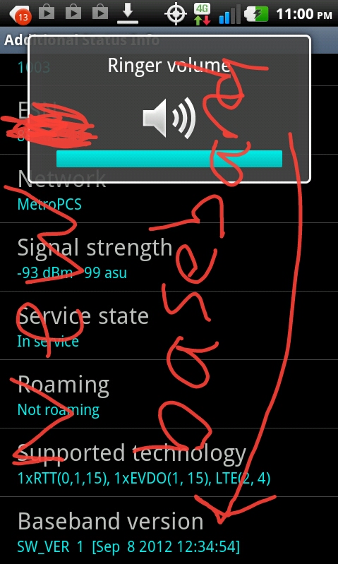

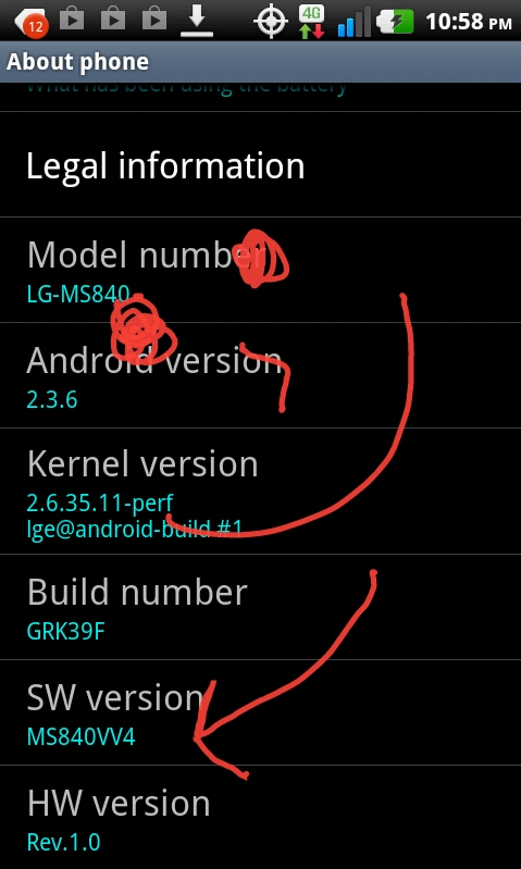

Complete success guys. New baseband and quickmemmo. No I'm going to flash vv4.

It seems smoother and haven't lost my 4G in like 30 Minutes which is a Big thing because I would loose 4G every 5 Minutes. VoLTE won't work unless ur in a VoLTE coverage area like Dallas Texas.
