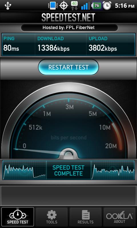

For those of you who may or may not believe that a baseband for a phone can make a huge difference?? This is my speedtest result from here at work since updating to only VV3, I used to max out at around 6mb
This is freaking insane speeds
Wish I had those figures. I've run everything from ZV8 to VV4. My speeds are never any faster or slower; only difference is connectivity ZV* drops 4G like it's hot and VV* keeps a better hold of 4G instead of switching every 20 secs. Boston area 4G blows anyway LOL, I get faster speeds miles outside of the city, not that fast though :D:D
