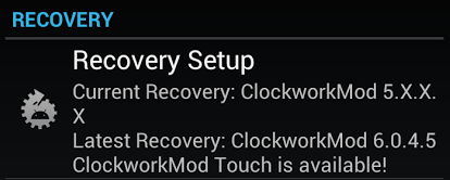

Quick synopsis on what has happened:
LG Spectrum VS920 - stock 4.0.4 with ZV9 update.
Extracted to C:\, configured the android for debug, and internet → modem, then plugged it in. Ran the .bat file, everything seemed to go fine, and it rebooted a few times. The .bat file started over again, so I thought at the time that it was done. I unplugged, checked around, and saw that Super User was successfully installed. Switched on Root Explorer in ES File Explorer, and it did prompt for SU access.
Downloaded Rom Manager, and it did not detect CWM installed. I read through this topic again and found out I should've run through the .bat file again, selecting YES when it asks if I am rooted.
Did so, and it did run through the rest successfully. There were 2 errors at the end where it said it could not find a directory, not sure if that is normal. I got the message at the end with programmer info, I hit the "any" key, and it disappeared. Figured at this point, it was now complete.
I launched ROM Manager again and it still said I needed a custom recovery. This time, I selected the option that I already had it, and chose the 3.X+ option. It then seemed to detect my version, but not very accurately, see screenshot below.
I am able to use Rom Manager to reboot into recovery. SU gave an error that it suddenly stopped right before shutting down, but I was able to get into recovery, backup using .tar format (which I read was more stable), and reboot the phone.
My question is:
ROM Manager shows that there's a newer version. I do believe I've seen both comments in this thread: to use ROM Manager to install CWM, and not to. With this screenshot, can you advise if I should allow ROM Manager to try and upgrade?
My question is:
You typically need to run the batch file once to root, then once to unlock.
If it's not detecting CWM on the phone, run it again and tell it that you're already rooted.
Tried that, and it does show that 5.x.x.x is installed. It shows there's an upgrade to 6.0.4.5 available, wondering if it is safe to install it through Rom Manager?
I've attached a screenshot of it.
