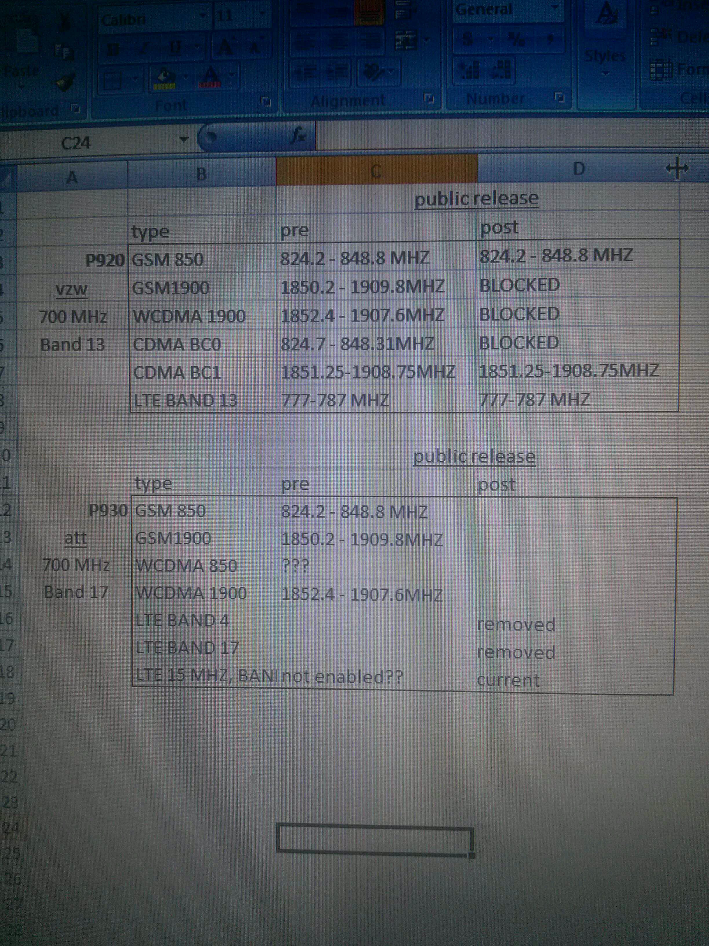

I'm unsure if this would help u big dogs out but I did some research on FCC and the radio differences between the p920 and p930. Hope it helps. If I hijacked ur thread let me know and ill go back to lurking. Lol.

P920??? Completely Different phone.....
Ummm VS920 is our model number...
FCC ID: BEJVS920 (LG Spectrum 4G [LG VS920])
FCC ID: BEJP930 (LG Nitro HD [LG P930])
