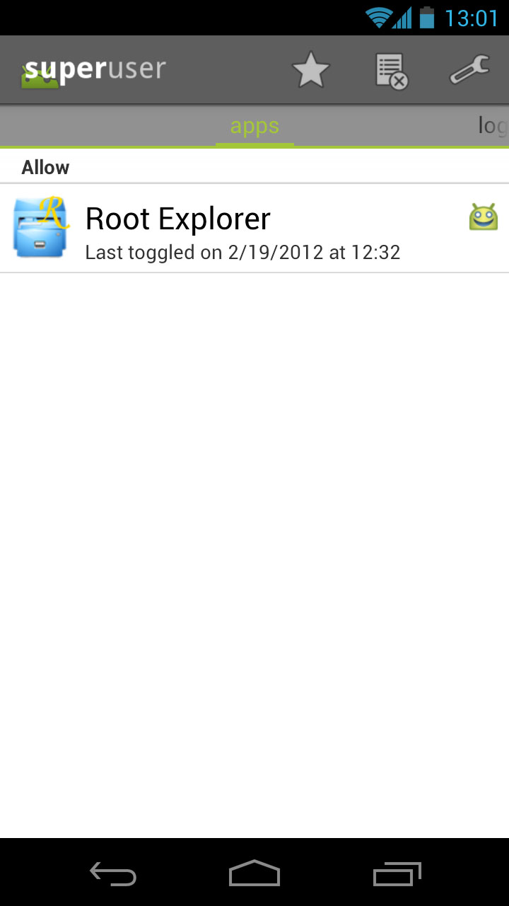

Okay now I am really confused.
I reran the root script after updating to 4.0.4 and it finished. Root Explorer is installed and working with superuser permission. Downloaded TiBu and Busybox and they are denied supperuser permission. Downloaded root checker and it says I do not have root. Ran the unroot script and reran the root script with the same results.
According to the log in Superuser the only app getting permission is Root Explorer. Volume +, TiBu, and Busybox are all denied.

I deleted the logs and retried openning the apps with the same results.
I clicked on Root Explorer on the apps tab (the only one listed) and Superuser allows me to toggle its permissions. SHould I delete it from the apps list also to clear everything from Superuser?

Makes sense, however root explorer is the only app listed on that screen. If you swipe the screen to the left it shows the log of apps that have requested Superuser permission. None of the other apps have ever made it to the app list since I did not install them until after applying the 4.0.4 update and they have all been denied superuser permission. Root explorer I installed to copy the OTA file into the cache/ partition.
Also when I ran the unroot script Superuser was not removed after the 4.0.4 update was completed. Is there something about the update that requires a change to the script to root/unroot?

scary,
Sorry for the delay in my reply, Paul...my stupid desktop PC crashed...<grrr>.
Anyways, I'm thinking this all has to do with how I only implemented a delete or the /system/app/Superuser.apk file and didn't do a proper uninstall of it and left a confused database behind.
I'm trying to do a manual uninstall using adb, but I'm getting a "failure" message that tells me that I might have to just do a recursive delete of the database files myself.

Paul,
LOL, sorry for the delay...had to flash back to stock 4.0.2 (the mempodroid exploit does not appear to work at all on the AOKP ROM, so I had to backup, flash back, and then tweak the scripts).
I added the removal of the /data/data/com.noshufou.android.su directory to the unrooting scripts and added a reboot after the unroot.
I also added extra checks to see if the files are (for rooting) and are not (for un-rooting) present and displayed the output of the ls (list files) commands.
I'll update the OP above (in a minute--give me 5 minutes or so to upload) with a new .zip file that you can try if you want to do the root and unroot process--it should be a little cleaner for the unroot phase.

I tried the new script and still no joy (downloaded it after 3:30 EST). I uninstalled and reinstalled all the drivers for Windows, and uninstalled all the apps requiring root except Volume +. Cleared the log in Superuser and went ahead and removed Root Explorer also. When I run the unroot script Superuser is not uninstlled but the phone roboots and the script finishes by prompting me to press any button to continue.
I am starting to think it may be something with the 4.0.4 OTA not allowing this exploit unless you have verified that it works on 4.0.4.
