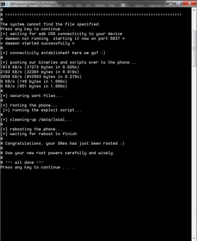

scary,
I used the file from seanmcnally over at android central. It is post 29 in this thread:
OTA Update IMM30B 4.04 - Page 3 - Android Forums at AndroidCentral.com
I attached a screen capture of the command window after the root script finished. Does that help?
Paul,
Sorry for the delayed reply, I was AFK for a few hours...
Yeah, it certainly looks like the exploit is not invoking the scripts on the phone (notice that after the "running the exploit script..." there's no "remounting /system" which is produced by the script2-root.sh script.
So, that indeed does tell me that the exploit isn't viable for some reason on 4.0.4.
Now, an idea occurred to me that the exploit does indeed work, but the offsets for the exit() function are different and need to be adjusted. I'm not sure I know how to determine this--I'll have to go back and re-read the original root exploit information to see if its a value I can try to determine myself (the prior values that I used were already published for us).
So, we're not totally dead in the water, but we're certainly stymied at the moment.
Let me do some more research and such and I'll get back with you (I'm not likely to discover this tonight, given the semi-later hour :)).
Cheers and sorry that the regaining root for 4.0.4 wasn't as straightforward.
I hope I can figure something out for everyone that will continue allowing them to gain root without unlocking your bootloader.
Thanks,
-SA

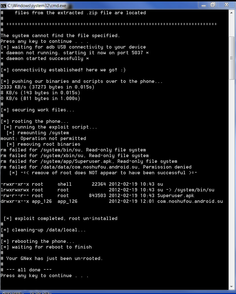

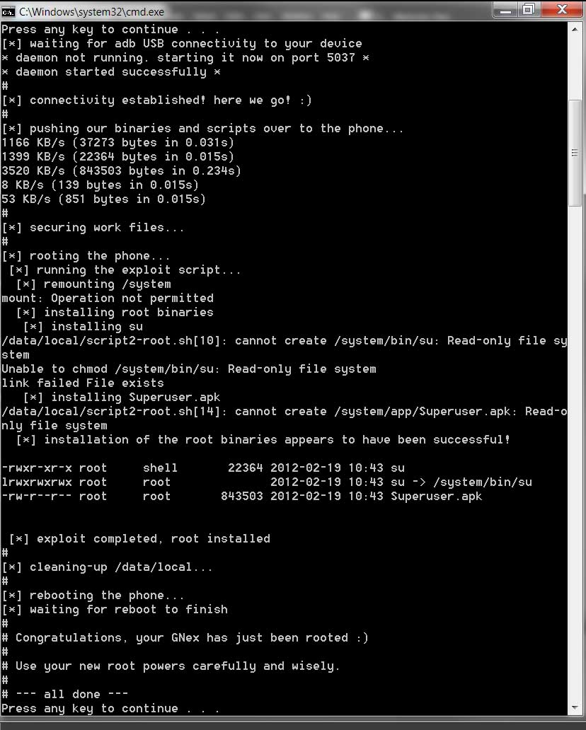

scary,
The new scripts do not seem to work either.
scary,
Yeah, looks like it...:( :confused: :mad:
Its actually getting a little farther with the auto-detect option: you can see that in both screen shots that /system was not able to be remounted as r/w (before, the script2-*.sh script was not even being invoked). So, the exploit is at least launching the script--its just not doing it with superuser/root permissions.
You can see that the su binary has been stripped of its SUID-bit in the permissions field (should be
"-rwsr-sr-x" vs. the "-rwxr-xr-x" you currently have).
Well, I might try to flash back to 4.0.2 stock and then install the 4.0.4 OTA tonight, but I'm thinking that might be a fruitless endeavor since you've done this for me, LOL...
Let me think and research this a little more (there's an IRC chat that one of the exploit researchers has offered-up that I might try to contact him about how to track-down what is happening).
Cheers!
-SA
