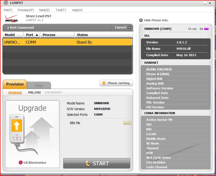

--Plug your phone into your USB port and put the phone into "Internet Connection" and Enable USB debugging.
--Open up LGPNST from your computer. (C:/LGElectonics/LGPNST/LGPNST.exe (Notice it's already seeing my phone COM7)
DO NOT OPEN UP LGPNST_CT. Open the correct application from the location above!!!!!!!
--Navigate to "FILE" and click "Select DLL". You should see the "VS910.DLL" that is located on your desktop. Select it. (If you don't see it, go back to
your desktop and right click and register it again and try again.)
--Once you select "VS910.DLL" CLICK ON THE YELLOW AREA where it says "STAND BY". Notice how the "Start" button, phone settings and other buttons are enabled now?
--Click on the "Phone Setting" button in the middle of the screen.

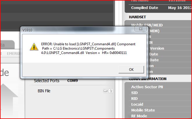

Everything worked fine up until i added my spc then i got an error saying ERROR: UNABLE TO LOAD [LGNPST_PORTMANAGER4.DLL] idk if i did something wrong? i followed all of the steps and my phone isnt in test mode.:(:(:(:(:(:(:(:(:(:(

Hmm. The spc never changes. It's unique to the phones meid. It's basically a password for your phone. It must be a glitch in the program then. I've never once heard of this ever happening. I would run through the lgnpst install files, reboot and try again.

ive finished the the test modefix. once to get to FILE and select DLL it looks like its about to work then all of a sudden, i get that error.To me it seems like it cant get to that specific dll but when i check its there where it should be.

once i choose the dll it works fine, when i input my spc it gives me the error saying it cant reach component 4 somethinglike that.
I mean I hate to say it but this is the first time out of at least 100 people using this guide that has reported this type of problem. I've never heard of having an error with the SPC other than it being the "wrong" SPC. The issue has to be in the installation.
Like I also said, you can input the info through the hidden menu as well. Being that I dont have an Esteem I cant give you step by step by step on how to do it. But I remember that it only takes common sense to do it. Other than that, I don't know what else I can tell you.
