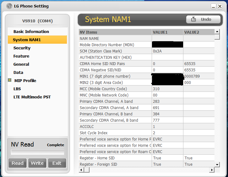

Really thankful for this thread and the guide was rather easy to follow but I still haven't fixed the problem. I'm out of test mode but still have no service, although I have bars and my 4g works fine. Can't send/receive texts or calls. Using prl 3029. My phone number shows up under phone status as well as MIN.
Just for clarity, is your ten-digit phone number supposed to be in the values for both NAM Name and Mobile Directory Number (MDN)? The guide doesn't mention MDN but it's being pointed to in the screenshot, or maybe I just read it wrong. Is Nam1 and Nam2 supposed to be MIN1 and MIN2 in the screenshot too? I just don't want to mess anything up ><.
MDN is your 10 digit phone number. I mis typeded and entered NAM. Nothing goes in NAM Name.
Then MIN1 is your 7 digit # minus area code and MIN2 is your area code.
Glad you asked that because it was an error. This should get you fixed. Report back and let me know. Glad your working thus far. ;)
Okay I left NAM Name blank and tried again, still doesn't work :confused:.
Last night before even posting on here I hit the Undo button thinking it would undo any editing I made and I'm not really sure what it did, so I might have messed something up there ><.
An image of what everything looks like should be attached. Is Value 2 next to MIN1 and MIN2 supposed to look like that or be a repeat of what was in value 1?

Unable to send/receive calls or text even though it shows me having bars. Both my phone number and prl are listed under phone info

"Your phone is not authorized for service at this time" is what I'm getting when I try to make any calls.
Under phone info it also says Mobile Network State is Disconnected.
Don't know if any of that information is relevant but I tried :confused:.
It sounds like you have no service. Call metro and tell them you have no service. The phone might need to be put back on the network. Udk. Worth a shot
Aight dude the window for me helping you on the phone has closed but this is what I found out for you.
2 things are happening here. 1. Your MIN is NOT your phone number which apparently is the case for some people. Call Metro PCS and tell them to give you your MIN#. If it's NOT your phone number then you know that was your problem.
