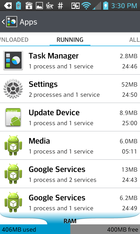

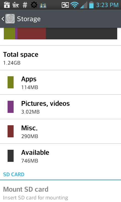

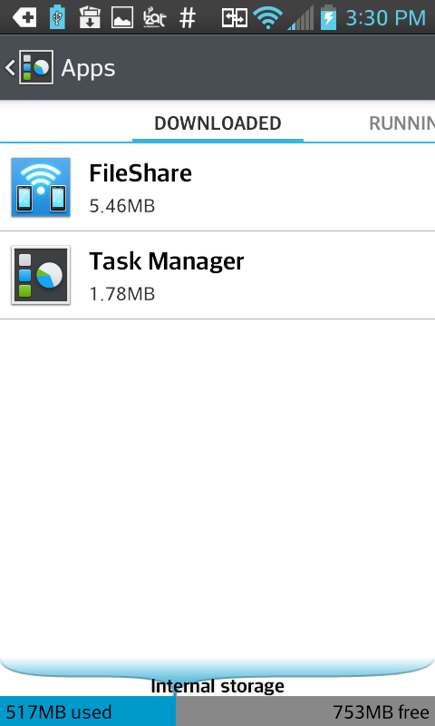

I just did a fresh install with your rom. But, I cant find the 4GB built in Storage.
Here are the OEM specs of the phone
System memory: 1024 MB RAM
Built-in storage: 4 GB
Maximum User Storage: 1.24 GB
Screenshot_2015-07-30-15-23-46.png Screenshot_2015-07-30-15-30-48.png Screenshot_2015-07-30-15-30-43.png
So where did the 4GB end up?
**EDIT**
Apparently, the 4GB of Built-in Storage advertised is only referring to the total hardware flash memory that is on the motherboard.
"How do we get Android to spit out the true memory & storage situation?"
https://groups.google.com/forum/#!topic/comp.mobile.android/e6svmGS1M-E[1-25]
So Im assuming that the 4GB memory is partitioned for 1024 RAM, 1024 User Storage, and the rest of the memory is filled up with Virgin Mobile apps and ROM. Unless anyone can shed some light on where the rest of the memory is.
View attachment 91611 View attachment 91612 View attachment 91613
**EDIT**
You can blame manufactures for that, all of them do it, LG, samsung, apple, etc. Its very misleading unfortunately...
