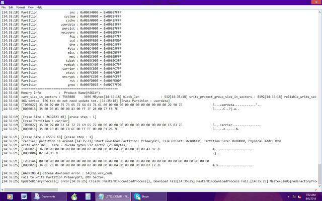

Hi I have read all the directions and look on different forums and i still cant flash my phone. I have tried in on different computers and unistalling the lg flash tool and reinstall and put the dll file and the firmware file in the lg flash tool and still nothing.
Can you paste a screenshot of the log?
[14:35:12] Memory Info : Product Name(H4G1d)
[14:35:12] card_size_in_sectors : 7569408 3696 MBytes
[14:35:12] block_len : 512
[14:35:12] write_protect_group_size_in_sectors : 8192
[14:35:12] reliable_write_sector_count : 1
[14:35:12] num_phy_partition_created : 3
[14:35:12] mfr_id : 0x90 oem_id : 0x4A
[14:35:12] prod_rev : 134 prod_serial_num : 8103197
[14:35:12] mfr_date :
[14:35:12] ======================================================
[14:35:12] 16G device, 16G tot do not need update tot.
[14:35:12] [Erase Partition : userdata]
[14:35:12] [T000027] 35 00 02 00 75 73 65 72 64 61 74 61 00 00 00 00 00 00 00 00 00 00 00 00 22 90 7E 5...userdata............"..
[14:35:13] [R000015] 35 00 0E 01 00 00 43 00 FF 3F 28 00 77 F8 7E 5.....C..?(.w..
[14:35:13] [Erase Size : 2637823 KB] [erase step : 1]
[14:35:13] [Erase Partition : carrier]
[14:35:13] [T000027] 35 00 02 00 63 61 72 72 69 65 72 00 00 00 00 00 00 00 00 00 00 00 00 00 E5 83 7E 5...carrier................
[14:35:14] [R000015] 35 00 19 01 00 C8 6E 00 FF FF 00 00 F1 26 7E 5.....n......&.
[14:35:14] [Erase Size : 65535 KB] [erase step : 1]
[14:35:14] "carrier" partition is erased.
[14:35:14] Start Download Partition: PrimaryGPT, File Offset: 0x100000, Partition Size: 0x80000, Physical Addr: 0x0
[14:35:14] write addr 0x0 size = 262144 bytes 512 sector (256KBytes)
[14:35:14] [T000023] 34 00 00 00 00 00 00 00 00 02 00 00 00 00 04 00 00 00 00 00 A3 92 7E 4......................
[14:35:14] [R000004] 02 6A D3 7E .j..
[14:35:14] [T262144] 00 00 00 00 00 00 00 00 00 00 00 00 00 00 00 00 00 00 00 00 00 00 00 00 00 00 00 00 00 00 00 00 ................................
[14:35:18] [R000023] 34 0E 78 8F 00 00 00 00 00 02 00 00 00 00 04 00 00 00 00 00 B7 C2 7E 4.x....................
[14:35:18] [WARNING 4] Stream download error : 14(rsp err_code
[14:35:18] Fail to write Partition PrimaryGPT, 0th Sector.
[14:35:18] [T000015] 2F 00 00 00 00 00 00 00 00 00 00 00 1A C3 7E /..............
[14:35:18] [R000031] 2F 00 00 00 04 01 00 22 00 00 04 00 00 01 01 00 00 00 00 00 00 00 00 00 00 00 00 00 F4 A4 7E /......".......................
[14:35:18] - Protocol Ver : 4
[14:35:18] - Algotrim Ver : 0x2200
[14:35:18] - PacketLen : 0x00040000
[14:35:18] - WebDownload : 0
[14:35:18] - StreamDownload : 1
[14:35:18] - SecureBoot HW : 1
[14:35:18] [T000004] 30 FB C1 7E 0...
[14:35:18] [R001855] 30 00 00 00 00 00 00 00 00 80 73 00 00 20 00 00 00 02 00 00 01 00 00 00 03 00 00 00 00 00 00 00 0.........s.....................
[14:35:18] Partition Count : 30

I flashed my Virgin Mobile LG Optimus F3 phone using the LG Flash Tool 1.8.1, the LGVM720_20130529_LGFLASHv151_Download DLL, and both LS720ZV6_03 and LS720ZV7_05 bin and now the phone resets every time I restart it. The flash finishes smoothly with both BIN's and I'm able to set everything up but if I shut down or restart the phone when it boots up it resets to stock automatically and wipes out everything. Any tips are much appreciated :-)

No, unfortunately, it goes to only 3%, then reports "Download FAIL!!". So the reflash hasn't completed, and the phone won't reboot.
Im sorry i may of read that wrong. Does your phone reboot?
No, it hangs at the "LG" spash screen.
I can boot CWMT, but can't restore from the backups I made. It reports that it can't mount /system. Same thing when I use CWMT to install a ROM from a zip file.
I've tried wiping data in CWMT, and reformatting the system and data partitions. Those actions also fail.
So I seem to be stuck.
