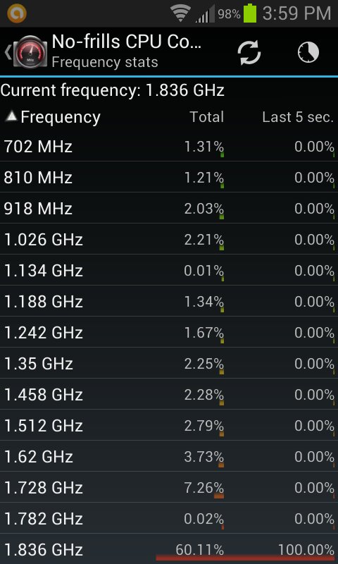

Love this phone. this is the Victorious-0.21 with its included kernel. cant speak on battery life yet as i just flashed it like an hour ago will report back . but with it set to ondemand here was my test result.
