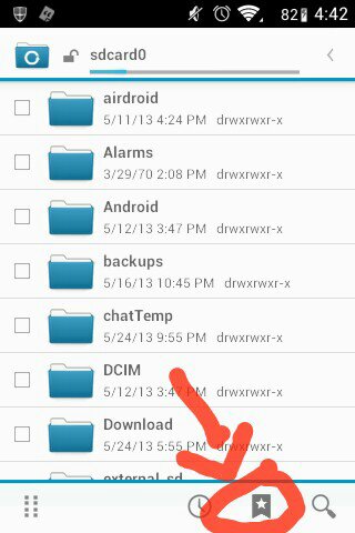

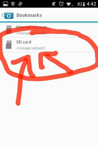

Anyone know why I can not access the External SD with File Manager after installing this?
Cuz its in a different location go to settings change to root access or something like that and then go backk and its in storage then go to sd card 1
Yeah i said that already, i copied the wrong link, I'll fix it.
I tried changing to the root access thing still doesn't work, can't access external sd
This

Worked, thank you :P
