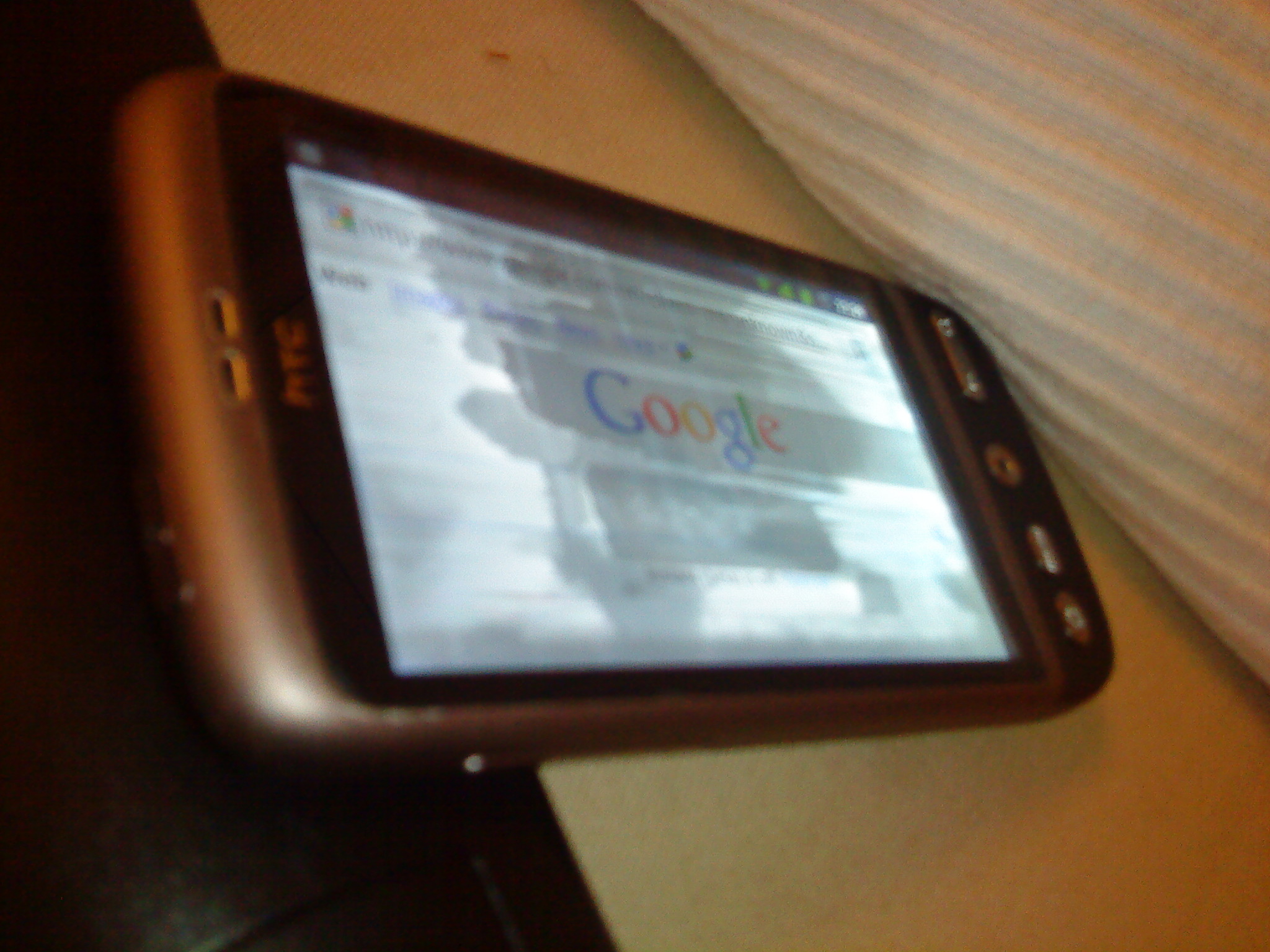

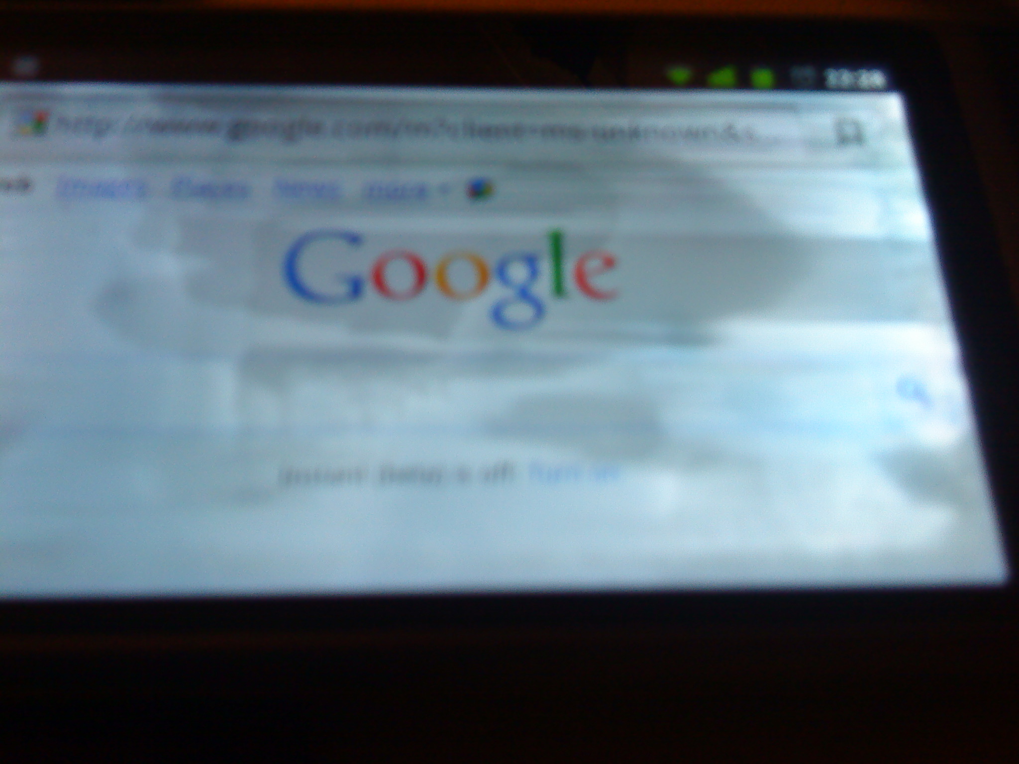

Well I've decided to air my shame. I hydrated my Desire twice in the last 2 weeks! :eek:
First time I managed to throw my phone into the shower before getting in. Cue a mad panic, battery pull and frantic towel dry. Thankfully it seemed that the water had not made it past the battery space and the phone worked fine.
Then earlier this week I managed to drop it into the washing up bowl. Worst thing was our hot water heater hadn't been on so I boiled a kettle full of water and poured it into the bowl. Hadn't got round the adding the cold when my phone decided to take a dip. This time I had to pause before (stupidly) deciding to thrust my hand in and grab the phone. I reckon it was submerged for about 5 seconds maximum. Anyway, took the back case off and pulled battery/cards and dried what I could with a towel but there was noticably more water around. I put it in a jar of rice and then later on transferred it to some paper napkins filled with rice and put it above the radiator for a few hours.
Whilst transferring it from jar to rice/napkin pouch I noticed that water was visible behind the glass (?). Quite a lot too. Probably covered about 5-10% of the display. This much water couldn't be seen at first when I put it in the jar. I wonder if:
a) Water all collected together after being kept still in the jar for a few hours
or
b) As the water was so bloody hot, it may have been that condensation formed afterwards due to cooling down.
Maybe it was a bit of both.
Anyway, after several hours in the pouch I returned it to a fresh jar of rice and left it there overnight. Then the following afternoon I sealed it in a pouch of silica gel and left it for a further 24 hours. The moisture had gone entirely (from what I could see).
Put the cards back in and booted the phone up. Everything seems to work. The only thing is that there seems to be some screen damage in the form of streaky lines/patches where the display is darker. Most noticable on white/light coloured backgrounds (Google homepage for example). Now it's not enough to stop me using the phone and after forking out
