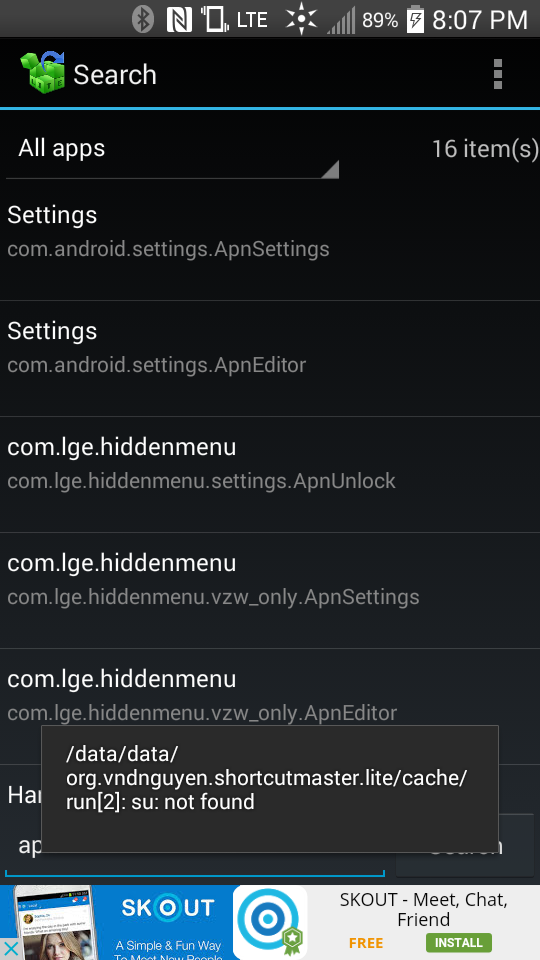

Can someone help me please. Im trying to get free boost mobile hotspot
