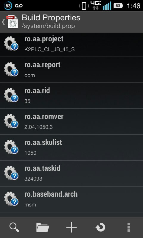

Got the firmware zip. Can I just rename it to PL80IMG.zip (Or some other filename)?
none of the OTA for cricket have .3
only .2 and .5
so with that zip open it up and change the the mainver once ending in .2 and try again and then changing the mainver ending with .5
Just to be clear, are we discussing the Cricket version or the Boost version? I've seen Cricket mentioned but the screenshot of russell's build.prop is the Boost version...
only .2 and .5
Okay. I'm going to see what the latest OTA ver. is. Then when I get home in a minute I'll edit the PL80IMG.
Edit: and of course, latest OTA is. 5. How did I get. 3? ;3
