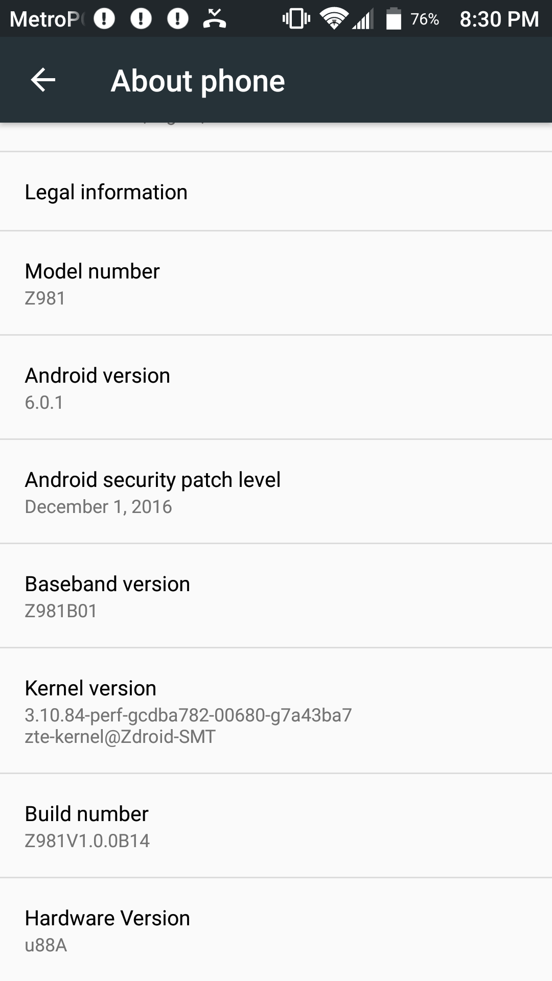

@Meepmoop - Great, so MetroPCS on the first B14 update. Which means it still has some of the older vulnerabilities. You'll need a PC for the program. Thanks to @brandonlee199966 for the link.

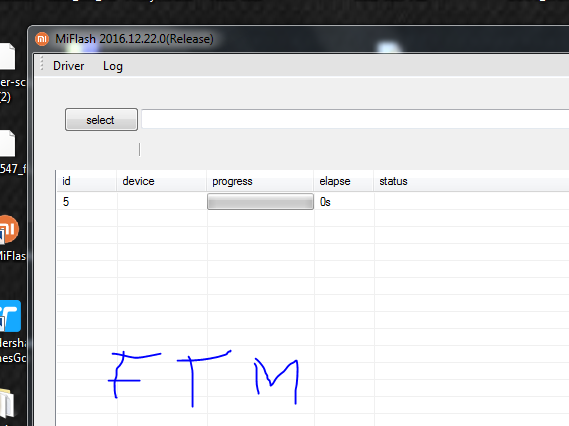

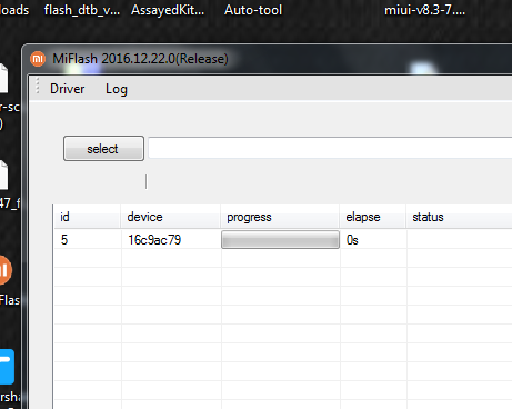

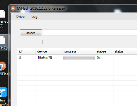

my zte v770 is seeing by miflash like this:
pic1 conected normal(phone ON)
pic2 conected FTM
pic3 conected Bootloader(download)
i dont have a service cable, so i used a normal usb cable(but i can modify it)
just to know if that method work.
thankyou!
ps. i whant to ask if the miflash can see the proper partitions on zte and flash it right
messing the partitions will result a brick
on zte-v770 the partitions are(see txt) and should be the same with zte Zmax Pro
