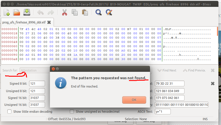

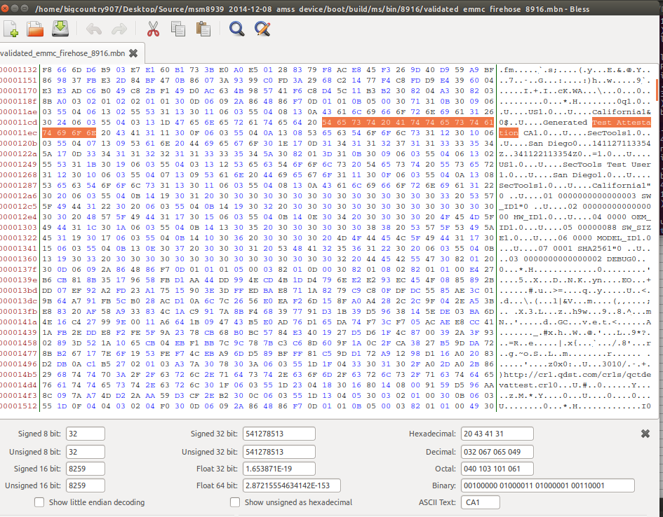

This is a Qualcomm Signed Loader.
The zte axon firehose isn't even signed by qualcomm test keys. And the one we are looking at is totally unsigned and unverified. This is beacuse ZTE is using the stock qualcomm programmer that is unsigned and unverified.
Considering i pulled the axon programmer from a nugget firmware unbrick package I would have to conclude this was not chaned after Lolipop.
This is the ZTE axon programmer.
A look at the bootloader aboot giving us an idea of how signatures are verified.
This is from aboot but.....
This is what we would expect to find if the file is signed by ZTE.
This does not mean that the firehose files for our device are not signed.
But looking at ZTE past record and considering the firehose for nougat is not signed I would think we have a great chance.

no unfortunately the axon 7 firehose was signed... i asked @tenfar [axon 7 firehose publisher] how he was able to get the signed firehose... got no reply from him..
I looked at the firehose again in my hex editor and you are right.
So yes any firehose is gonna need to be signed by ZTE.
Only place to find signed firehose would be in a fastboot rom for a zte device with the same chip. I find alot on Needrom usually.

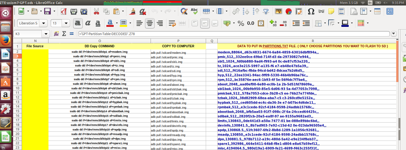

Then issuing the following commands to get the dump.
adb shell
su <<<<<---- Not needed in TWRP
dd if=/dev/block/mmcblk0 of=/sdcard/EMMC-Dump.img
That would be a copy of the emmc.
Next in linux shell run this command to pull the GPT Partiton Table.
dd if=/path-to/EMMC-Dump.img of=/path-to/GPT-Dump.bin bs=1 count=17408
That copies the GPT to an image or .bin file.
Next using linux hexdump.
in a linux terminal
hexdump -C -v /path-to/GPT-Dump.bin /path-to/GPT-Dump.txt
I can take the resultant txt file and put it in my spreadsheet to decode the GPT and show me the partition layout.
For Example.
So basically you guys would be set.
