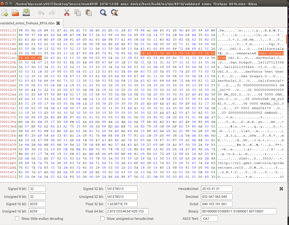

Downloading axon 7 firmware i found that the unlock is very similar to HTC but much easier.
ZTE provided a Fastboot.img that enables fastboot and allows oem unlock.
My guess is that the fastboot image they provided was originally made for zte to service the device.
My thought is if we can make the same changes in the fastboot (FBOP) partition (Set the flags to allow fastboot and oem-unlock) we can flash FBOP using miflash.
Who knows if we are lucky the axon 7 fastboot.img might work on our devices with small modifications.
So as said Miflash can flash partitions as long as we have the firehose. We can get the firehose cause ZTE uses default qualcomm hoses. Unsigned.
The axon 7 is unbrickable using MIFlash and the firehose from Zuk Z2.
http://www.androidbrick.com/zte-axon-7-unbrick-guide-qd-loader-9008-edl/#
http://www.androidbrick.com/zuk-z2-z2-pro-qpst-qfil-miflash-rom-flashing-guide/
We know that the firehose is not Vendor specific cause it works for the ZUK 2 and the Axon 7 and theese are from different Vendors.
I would bet our devices have the same security scheme as the axon 7.
Another interesting fact is that there is a axon7tool that can backup axon7 partitions and GPT with the phone in edl mode.
This tool has to use the same protocol as MiFlash.
Maybe saraha ??
I know these protocols are very well documented so it is very possible someone can write a linux tool using these protocols to backup the partitions from our devices. And write them too.

Its not alot.
And to flash the FBOP image this is the line from the partition.xml used by MiFlash.
This is from partition.xml
<data><program SECTOR_SIZE_IN_BYTES="4096" file_sector_offset="0" filename="fastboot.img" label="fbop" num_partition_sectors="32" partofsingleimage="false" physical_partition_number="0" readbackverify="false" size_in_KB="128.0" sparse="false" start_byte_hex="0x321a8000" start_sector="205224"/></data>
So where im at is.
#1 We know how to write partitions using MIflash.
#2 We know flags in FBOP partition allow the bootloder to be unlocked.
What we are missing.
#1 we need a copy of the GPT from our devices.
#2 we need a copy of all partitions from our devices.
Conclusion.
If we can develop a tool like axon7tool that uses the same protocol as miflash we can get these things.

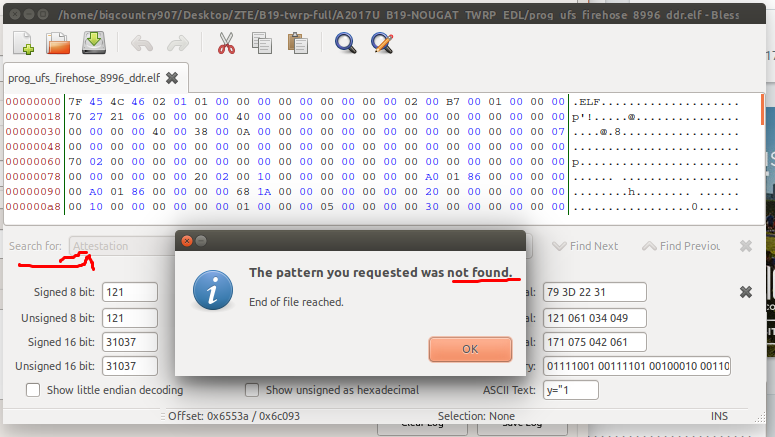

Not sure about the unsigned firehose part, every 8952 firehose i tested got rejected in miflash, the axon 7 developer who provided axon 7 firehose said that vendors started signing it since mm... so I'm not sure about that.

This is a readme.txt file from mainstream source code that i have. Which means yes.....I have the source files to compile programmers. I would think that these source files could be used as a road map to build our own programmers. That is exactlly what vendors do when they make upgrade tools. So lets take a look at this and see what this text file is telling us.
Firehose is a new serial protocol that can be used with "Emergency DownLoad" (EDL). This protocol is fast and there is *no need* for a "single image" file to get into mass storage mode.
There are no pre-checked-in deviceprogrammer binaries, what is compiled and present in the build is what is ready for use.
The deviceprogrammer image is compiled into the build\ms\bin\<platform> directory (e.g. build\ms\bin\8974\), which is the directory where other build compiled images such as sbl1.mbn also reside.
To create the "programmer", go to the build\ms directory and type
build deviceprogrammer BUILD_ID=<build_flavor>
NOTE: For best results, run a CLEAN before each build attempt
Examples
build deviceprogrammer BUILD_ID=AAAAANAA
-- creates prog_emmc_firehose_8974.mbn, used for programming device
b8974 deviceprogrammer BUILD_ID=AAAAANAA DEVICEPROGRAMMER_IMAGE_TYPE=read
-- creates READ_emmc_firehose_8974.mbn, used for reading data back from device
b8974 deviceprogrammer BUILD_ID=AAAAANAA DEVICEPROGRAMMER_IMAGE_TYPE=gpp
-- creates GPP_emmc_firehose_8974.mbn, used for creating General Purpose Partitions
Examples

This is a Qualcomm Signed Loader.
The zte axon firehose isn't even signed by qualcomm test keys. And the one we are looking at is totally unsigned and unverified. This is beacuse ZTE is using the stock qualcomm programmer that is unsigned and unverified.
Considering i pulled the axon programmer from a nugget firmware unbrick package I would have to conclude this was not chaned after Lolipop.
This is the ZTE axon programmer.

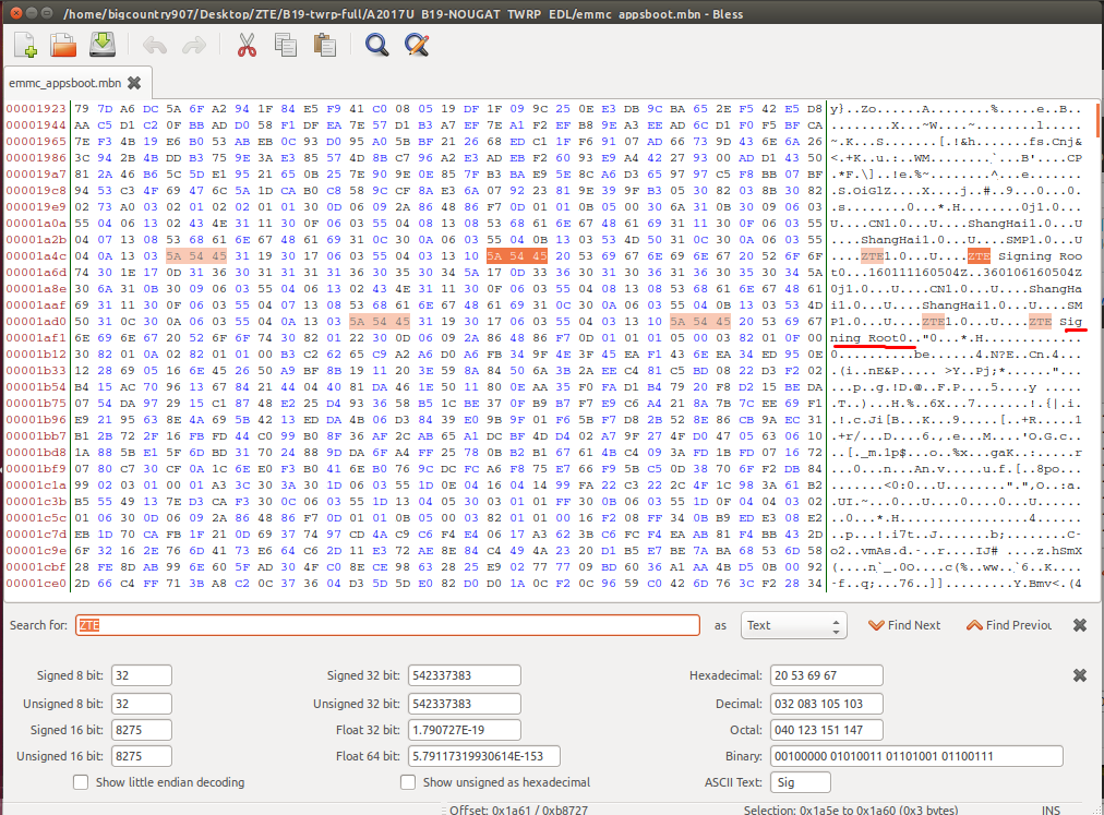

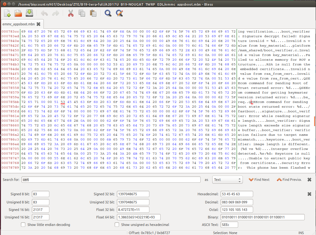

A look at the bootloader aboot giving us an idea of how signatures are verified.
This is from aboot but.....
This is what we would expect to find if the file is signed by ZTE.
This does not mean that the firehose files for our device are not signed.
But looking at ZTE past record and considering the firehose for nougat is not signed I would think we have a great chance.
